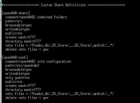

That sounds as if the missing samba share is the only problem.
Did you install openHAB manually on your raspberry? In this case search for instructions on how to install a samba share.
If you used the openhabian image the usual samba shares should be installed already.

If you used an image you most probably used the “openhabian” image. Can you confirm that?
If yes samba is installed and you can connect a network drive from Windows using the credentials for logging in as user “openhabian”.
For ssh you need a tool on Windows to connect like putty. Using the user “openhabian” will work there as well.
Thanks guys for the help . You directed to right direction thanks. Sorted it out , got Samba working and got the the editor to work. Thanks .
