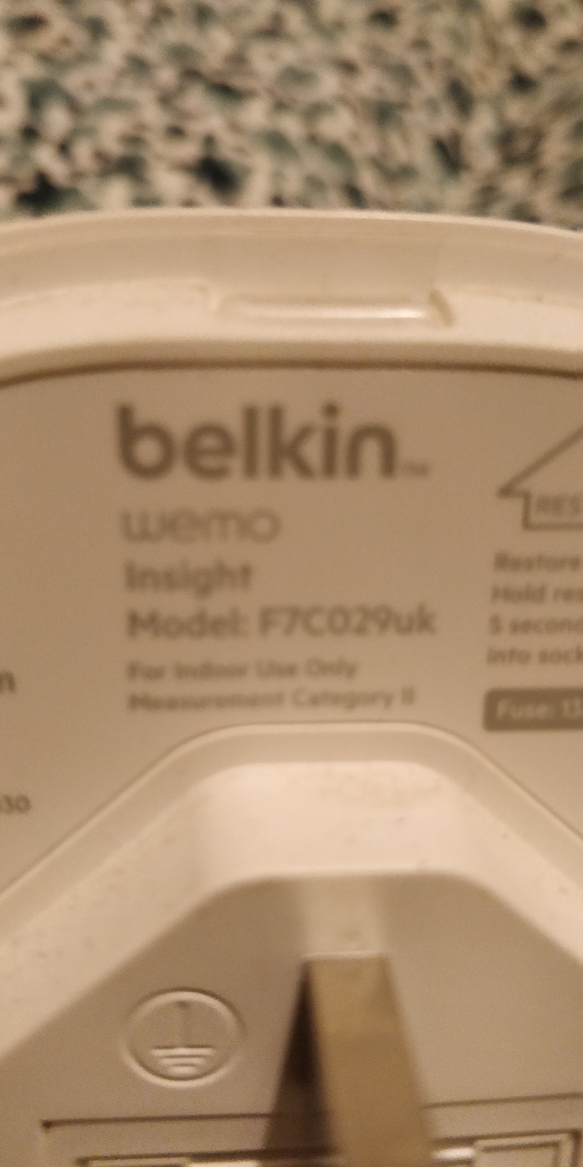

Hello I have successfully configure a WeMo Insight Switch so that I can turn if off and on. In Items it is as follows:
Switch BedroomLights “Bedroom Lights” (FF_Bedroom)
I can switch it off and on whichis good but the Wemo OpenHab page also shows that powerconsumtion can be shown but it is not working.
I have tried:
Switch BedroomLights “Bedroom Lights” (FF_Bedroom) { channel=“wemo:insight:BedroomLightsr:currentPower” }
not working. I have also tried using VisualCode and right clicked the Create Items from CHannels and only the state comes up IT can definitely show power but I can’t see what is wrong.
