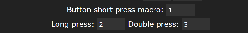

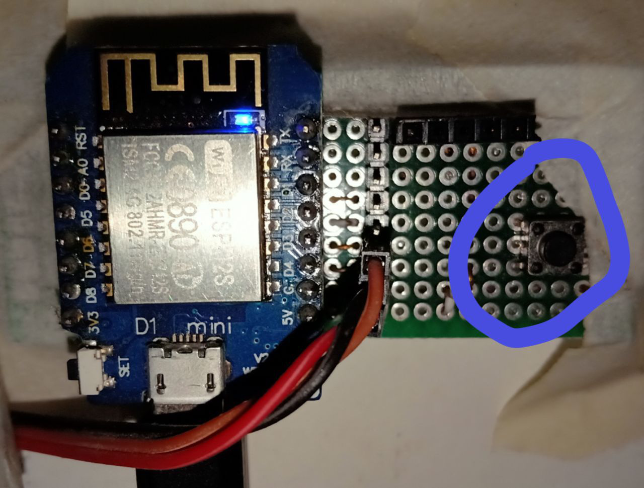

Is there a way to make the wled works like a touch dimmer? I build my kitchin lights whit w2812b strips and I wood like too be able to make it work whit short press to turn on and off and long press to make it dim up and down like a touch dimmer.
Yes It is Possible can do that.
Connect push button in Wemos mini Pin D2 and GND .
Then in WLED Setting page Time and Macro Page set macro
These macros can be executed using Button functionality
Button functionality have 3 action 1. Short Press 2. Long press 3. Double press
This is currently supported for the following parameters:
A, R, G, B, W, R2, G2, B2, W2, FX, SX, IX, FP, PL
ref this page :HTTP request API Ā· wled/WLED Wiki Ā· GitHub
Macros Ā· wled/WLED Wiki Ā· GitHub
My SetUp:
