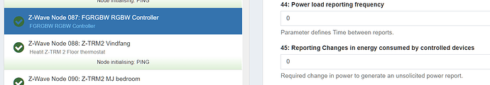

The minimum in the database for parameter 44 and 45 was set to 1 instead of 0. I have changed this so in the next 2.5 zwave snapshot (after the database changes got merged into the binding) you should be able to upgrade and use 0.
Because my new device supports the 0 values to shut up reporting. Older devices might not.

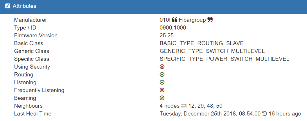

They have the same Type/ID, but (I would guess) different firmware versions.
I only own the new type and the current data base limits wouldn’t allow the 0 setting through.
Maybe I misinterpreted your question. I thought that you were updating multiple database entries for different firmware versions? If there is only 1 database entry, then this is fine - if there are multiple entries, then it is not such a good idea.
Currently only one, but valid for ‘All FW versions’
This is where I’m unsure, If you can/will/prefer differentiate on FW versions, just loosen up the limits or make a new entry.
