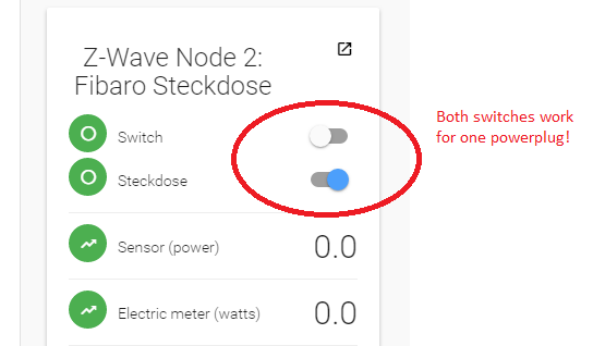

On Paper-UI I saw that every switched device has 2 (!!!) switches. One is switched by Habpanel and one is switched if i use google-home-mini, but they both are for the same device.

It seems that you have 2 Items linked to this node.

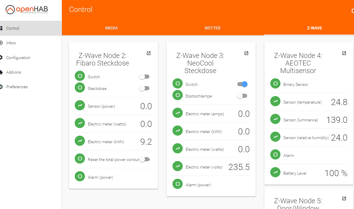

Can you post a screenshot of the Thing Channels expanded? (to show which Items are linked to it)
Yes here’s a Screenshot:
Maybe I should set the Item Linking “Simple Mode” off and link the Items new?
Yes, I would advise that
OK, problem solved. There were really 2 Items linked to the nodes/things. But I only could see it after disabling “Simple Mode”-Item Linking. Now the double-links are deleted and the Habpanel-Buttons are new linked. So the User-Interfaces are syncronous. Thank you for helping!
