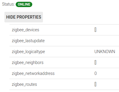

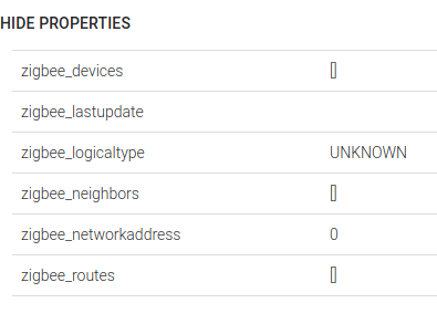

I followed your tutorial again this is what happens after it:
Is the stick online? If not, it makes no sense trying to add devices.
Surely it is.
Hmm Thats odd.

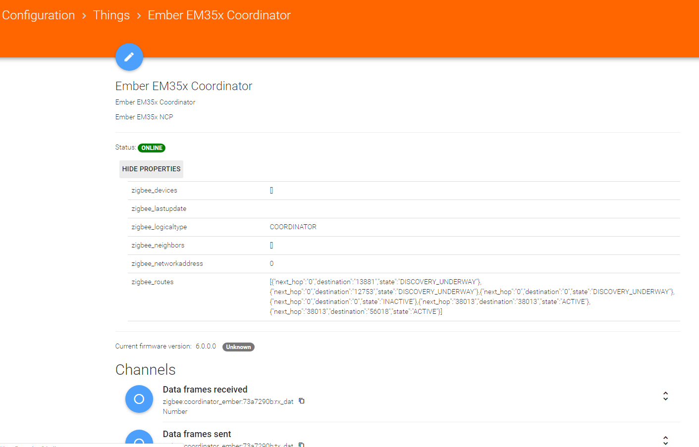

I dont think it has been fully included. If this is the coordinator it looks very strange.
This is my zigbee coordinator:
I know without the symlink my Coordinator looks like yours too. But I followed the tutorial exactly and I even setup a pie with openhabian.
