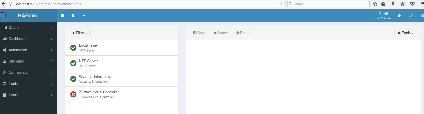

What could be the reason for the Z-Wave serial controller showing up with Offline icon when run within eclipse (see img1)?
