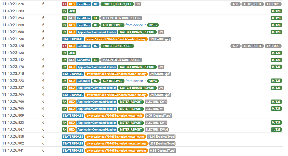

I can’t see anything wrong, it sends the command, the controller receives the command and the state is updated:
I can only suspect a hardware error:
The swith item however does not turn off the poweroutlet. I hear the plug switching (when I toggle the switch from within openhab) but the light stays on.

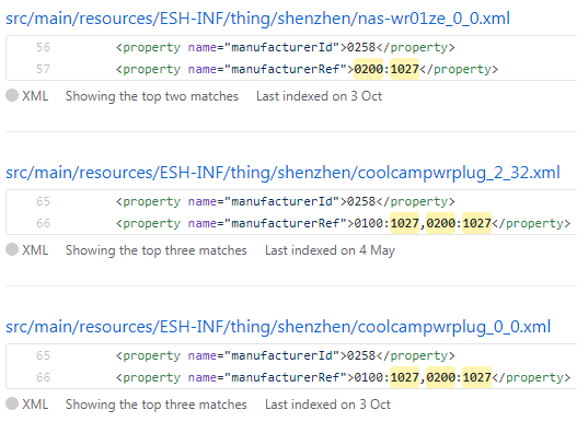

There appear to be two devices with the same IDs and overlapping versions -:
The bottom 2 are ok since they are different versions of the same device, but the top one has no version, so it overlaps. We need to have a look through and see if it’s still like this, or if one of these has been deleted - deleted things in the database won’t actually be deleted in the binding, so this could cause this to happen. Or, it could be a bug in the check of versions in the database…
