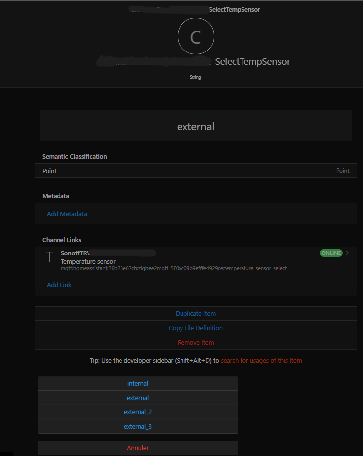

Some metadata StateDescription seem to be in play and yet MainUI does not show it
I’m on OH 5.0 stable.
I have an item of type string that obviously seems to have some metadata constraining the values it can take and yet MainUI does not show any metadata, as the screenshot below shows (taken after having clicked on the value as if I wanted to change it - see the popup at the bottom)… I must be missing something obvious but I can’t find what exactly…
Where exactly are the 4 values (internal, external, external_2, external_3) stored?
Thanks,
Bindings can also provide state/command description metadata to Items linked to a channel, those aren’t real „metadata“ though, so they aren’t displayed.
ok, thank for the answer. When you say “not real” metadata, you mean thay they can’t be changed? Or something else?
I think you can override it by adding state description or command options metadata, but I am not sure.
