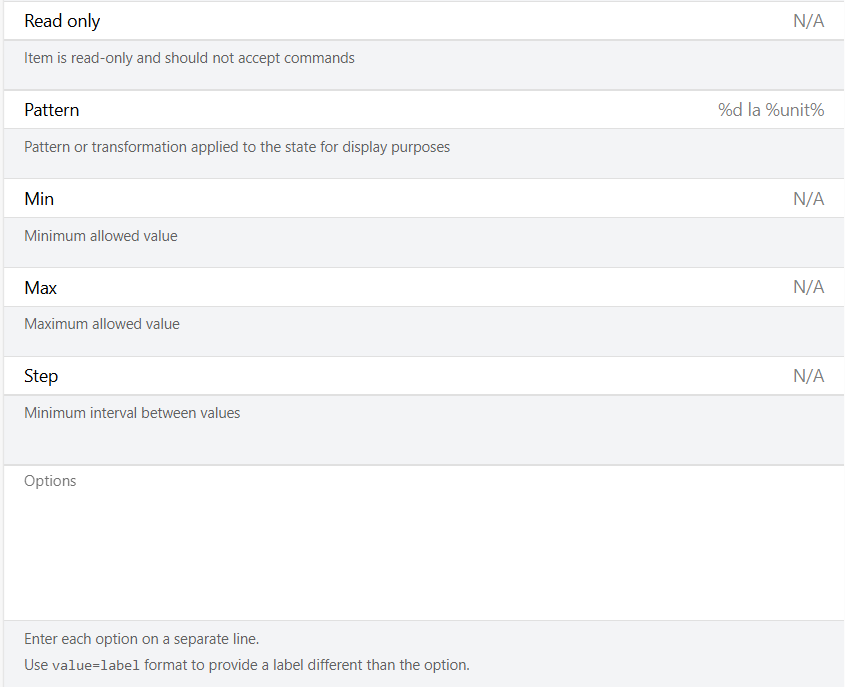

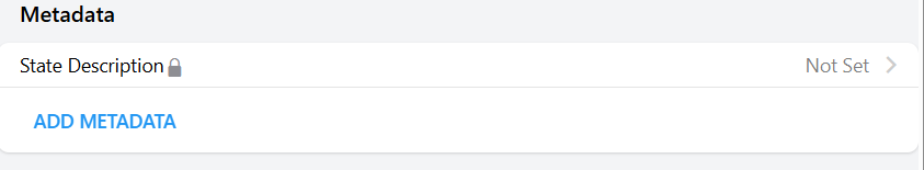

It shows like this in MainUI:
(Note “Not Set”)
Yet, when I click the locked state description, I see this:
The pattern from the YAML is there, but this is read-only, I can’t edit it. Fair enough, except that I don’t understand why this is “not set”, and the fact that I still have “Save” in the navbar.
But, nothing prevents me from adding a “new” state description using “ADD METADATA” (did this use to be capitalized - it looks a bit “messy” IMO?). However, the “page” that comes up after “adding” is the same, non-editable one that is shown above, still possible to “save”, but still not editable.
So, it seems to me like you’re in fact not allowed to add state description metadata to read-only Items.
