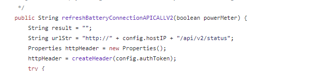

Hello, that is not correct. The binding is supporting API V2 Here an evidence out of the source code:
Therefore, it should also work for @marrxx, unless something has been changed recently. At least I don’t see anything at sonnen.
