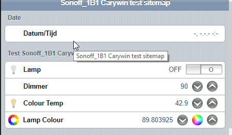

EDIT, Decided to post the extra info needed right away. I am looking at the mqtt status using this cmd in a terminal:
 mosquitto_sub -v -h 192.168.178.238 -u admin -P ****** -p 1883 -t '+/Sonoff_1B1/#'
And when i use the Sonoff web-if and i set the slides for Cold—Warm and Dark—Bright, i see the results (values 90 and 42.9) both in the terminal and in the OH sitmap.

This is the sitemap file which i use for this test:
sitemap sonoff1b1Carywin 		label="Sonoff_1B1 Carywin test sitemap" 	{
	Frame label="Date" {
		Text item=Date
	Frame 	label="Test Sonoff_1B1 Carywin"{
		Switch 		item=sBedroom_Lamp 	label="Lamp [%s]"
		Slider 		item=dBedroom_Lamp 	label="Dimmer [%d]"
		Slider 		item=ctBedroom_Lamp 	label="Colour Temp [%.1f]"
		Colorpicker 	item=cBedroom_Lamp 	label="Lamp Colour [%s]"
