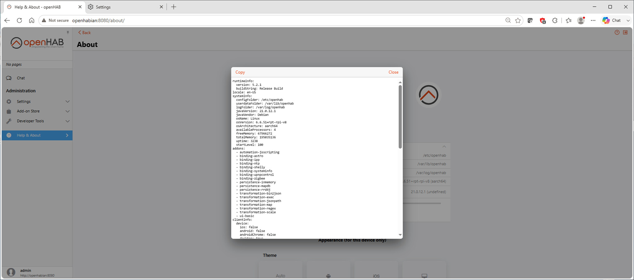

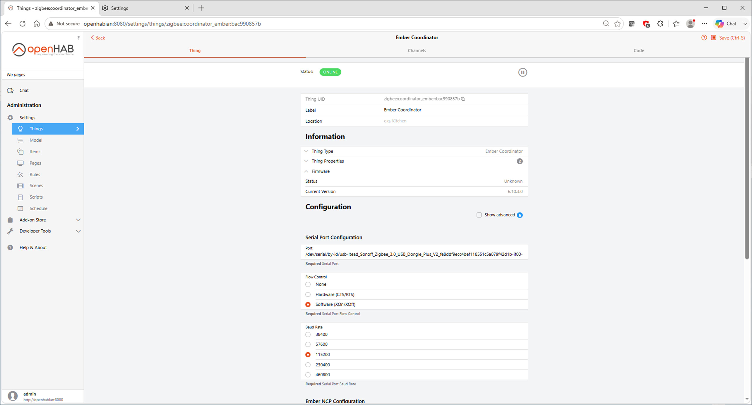

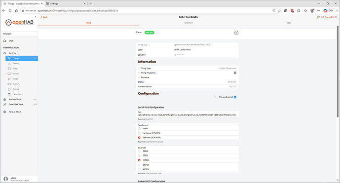

Ok so I built out a new image on my Rpi4 with 5.2.1 and did the 30 system settings in openhabian-config then 35 serial port then option 2 to move bluetooth (you may not need to on yours but I did it for gp’s) added the binding then took a brand new fresh sonoff dongle E with the 6.10.3.0 firmware straight out of box plugged it in and manually selected ember coordinator under add things. I then selected 115200 baud and when I pulled down serial it populated the port with 2 options /dev/tty/usb0 or the long /dev/serial/by id (btw works with either) then it went to initializing I saved then I toggled the initializing switch and it stuck on that like yours did.
I then rebooted the Rpi and same as you no help. I then unplugged the dongle and then plugged it back in it switched to offline I then marked it disabled then I waited for it to come back as thing disabled then I enabled and it switched to initializing for a second then it came online and works fine. with that being said it does not seem like an OpenHAB 5.2.1 version issue. Or a zigbee binding issue.
as the below picture shows
and this is what I am running it on
Also, I did check and it does look like openhabian does do the linux needed tweaks as it show as openhab already a member of dialout and tty
Hope this helps
