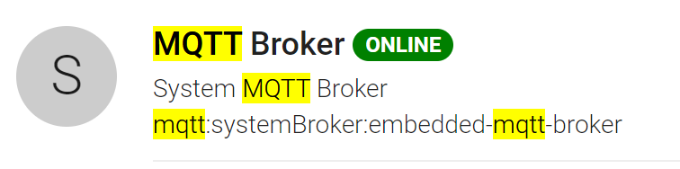

Apologies if this is a stupid question but can I use the things described in the OP with an embedded broker that I created with the Paper UI:
If so, what’s the syntax to put in the things file that works with this embedded broker?
After configuring the embedded broker, you next need to create a bridge to that broker in your things file like so:
Bridge mqtt:broker:bridge "MQTT Broker Bridge" [ host="localhost", port=1883, secure=false, username="username", password="S***tyPassword", clientID="openHAB2" ]
