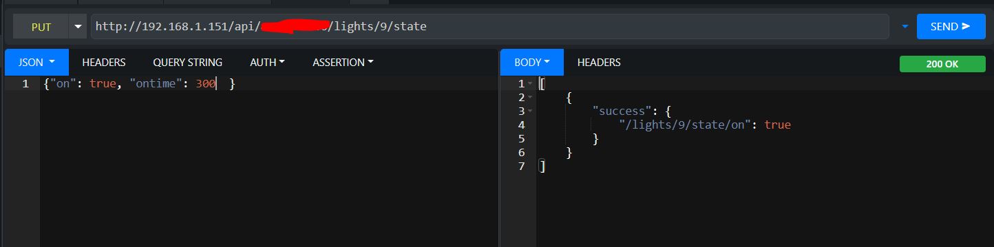

with the API it worked:
from CLI:
curl -X PUT -H "Content-Type: application/json" -d '{"on": true, "ontime": 30 } http://192.168.1.151/api/4E2BA46CB6/lights/9/state
and browser:
