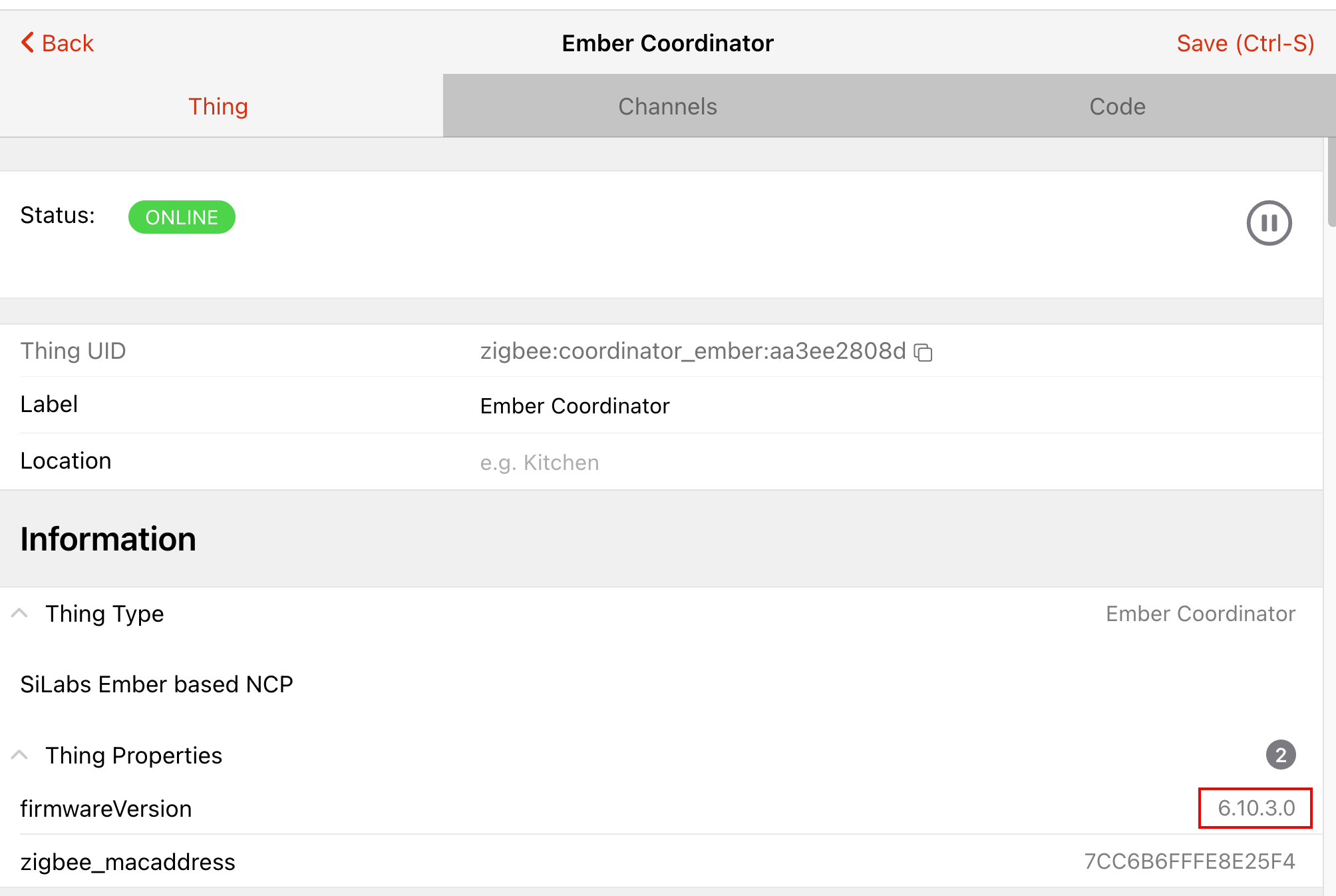

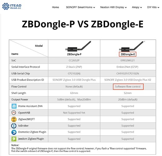

Well, some great progress here: These dongles came indeed with software flow control (XON/XOFF) but on 115200 though…
UID: zigbee:coordinator_ember:aa3ee2808d
label: Ember Coordinator
thingTypeUID: zigbee:coordinator_ember
configuration:
  zigbee_port: /dev/ttyUSB0
  zigbee_channel: 11
  zigbee_initialise: false
  zigbee_concentrator: 0
  zigbee_trustcentremode: TC_JOIN_SECURE
  zigbee_extendedpanid: 8D02E983714C2084
  zigbee_baud: 115200
  zigbee_flowcontrol: 2
  zigbee_panid: 1087
  zigbee_powermode: 0
  zigbee_txpower: 0
  zigbee_networksize: 25
  zigbee_linkkey: 5A6967426565416C6C69616E63653039
  zigbee_childtimeout: 86400
  zigbee_networkkey: C1287065A4AD3EA69778F21CB36E57EA
  zigbee_meshupdateperiod: 86400
At least, I get much more log output:

After a “Reinitialize Controller”, the dongle came “online” instantly:
I guess, this is the solution. Maybe @LoGi can mark it as such even though he won’t be interested in personally anymore as he has switched to another dongle. But maybe this finding may help others :wink:
EDIT: Just checked the ITEAD website. There they state, that the ZBDongle-E is being shipped with software flow control:
I’ve created a pull request for documentation change as the current version was misleading for me :wink:
