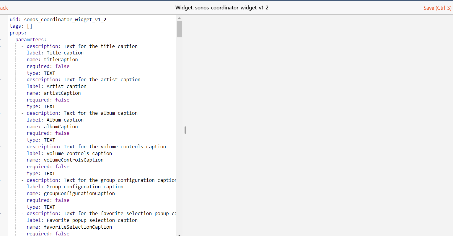

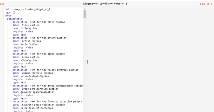

I just updated my installation to 4.2.2 and the widget works as expected. Are there any supicious entries in your logfile?
nothing I am aware of, but the widget also doesn’t appear even in the widget editor:
btw I have the rules file in: /etc/openhab/automation/js/sonos_coordinator_rule.js
