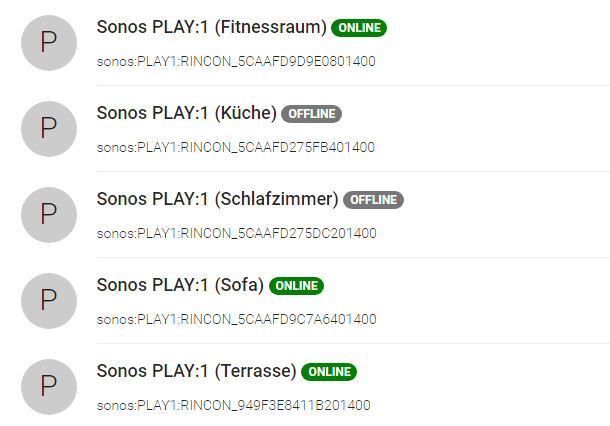

no, the issue still exists. i did the update and this is the status of my sonos devices:
I’m curious as to why some of your SONOS units are online and others are not?
It happens randomly… :wink: And then it goes offline.
