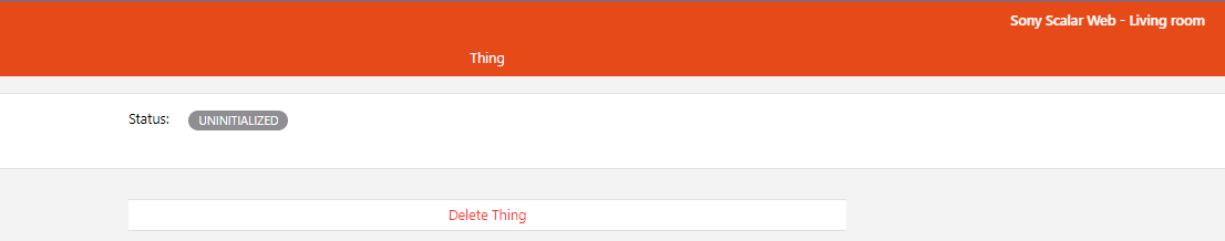

Hi, after a reboot the things shows UNITIALIZED for both Simple IP and Scalar. Running 3.2.0 Release build and installed from marketplace. Removing the binding and reinstalling brings it back to life. Using the Sony binding since 3.2 M5, had same issue there.
Any suggestions how I can fix this?
This has already been discussed a couple of posts above. Afaik there no fix for this problem yet.
Thanks, sorry must have missed that.

I’ve created a new topic Problem with binding from marketplace being installed and subsequently uninstalled on OH start-up for this issue as my current analysis of the log files have been unsuccessful. At least I would have expected to see a warning or error message in the log files, which I haven’t.
So for now the only option I see is to await a helpful response unless you have made other or complementing observations than I’ve stated in the issue topic.
I’ve published a new version on the marketplace that should fix the issue with binding removal on (re-) start of openhab.
@andan Removed and re-installed the binding, after reboot loaded as planned :smile:
Thanks for the fix.
What could help if you copuld send me details of your item and UI configs. Please also check if the items are properly linked to the channels (one channel per item, no orphan links etc).
Works for me as well! Thank you!
And now I can install the binding from the marketplace as well.
