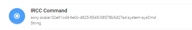

Strange, but when I deleted both the IRCC/Scalar devices from the Things list, and restarted, this time the binding only found/placed the Sony IRCC thing in my Inbox. I was able to add that one (I was in the “HOME” menu on my DN1060 and saw the prompt for adding Openhab as a control device). I can’t get the Scalar device to show back up in my Inbox, though…
@tmrobert8 Spent some time on the phone with 1st and 2nd level support. The issue is now escalated to engineering support. My bet is that the feature to enable Remote Control is not exposed or doesn’t exist in the firmware. I’m hoping it’s just the former.

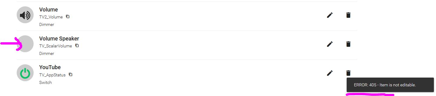

Scalar and simple IP works with Sony Bravia KD-65XD8505.
I can control volume, but it gives me warning:
2017-08-21 20:35:02.287 [WARN ] [thome.io.rest.core.item.ItemResource] - Cannot update existing item 'TV_ScalarVolume', because is not managed.
What does it mean and how to fix it? For example I cant change name of item. Now I cant see it in Things>Channels view.

Justas,
How did you create the “TV_ScalarVolume” channel? That’s not a channel name that is automatically created by the binding and I believe there must be a mapping error between the channel and item (just a guess however). Here is the name of the channels (created by default) by the binding for my tv:
You’ll see the channel is linked up to a really awful looking string - not something simple like you have.
As for the IRCC commands in scalar - there is a an IRCC channel that accepts a string. Here’s what mine looks like (again the default names):
This channel will accept two types of strings. If you send it the raw value (“AAA…”), that will get sent. An alternative is to look in your transform directory - you’ll see a file called “scalar-xxxx.map” and will contain a bunch of “Cmd=AAA” stuff that the TV reports that it supports. You can simple send the Cmd show in the file.
Example (from mine) - in the map file I have:
Hdmi1=AAAAAgAAABoAAABaAw%3D%3D
Hdmi2=AAAAAgAAABoAAABbAw%3D%3D
Hdmi3=AAAAAgAAABoAAABcAw%3D%3D
Hdmi4=AAAAAgAAABoAAABdAw%3D%3D
I just simply need to send “Hdmi1” to the scalar IRCC channel, the binding will look it up in the map file and send the appropriate command to the TV.
