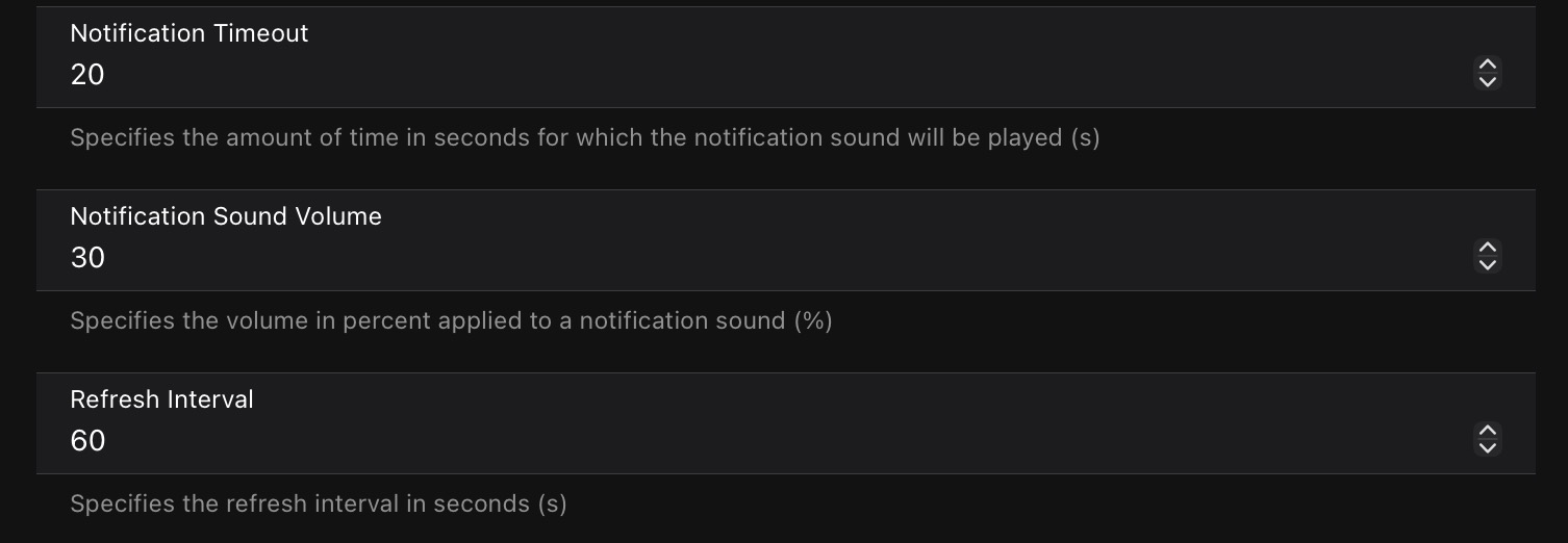

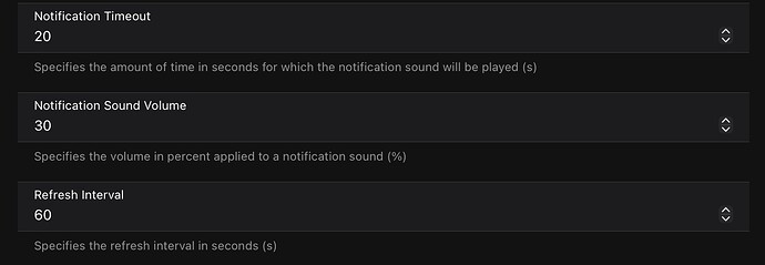

Sonos

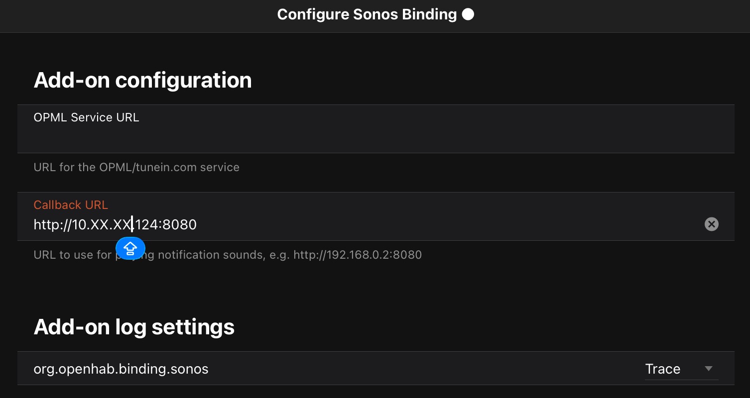

On the OH side, I added the Sonos One’s IP to the binding configuration, but that didn’t change anything.

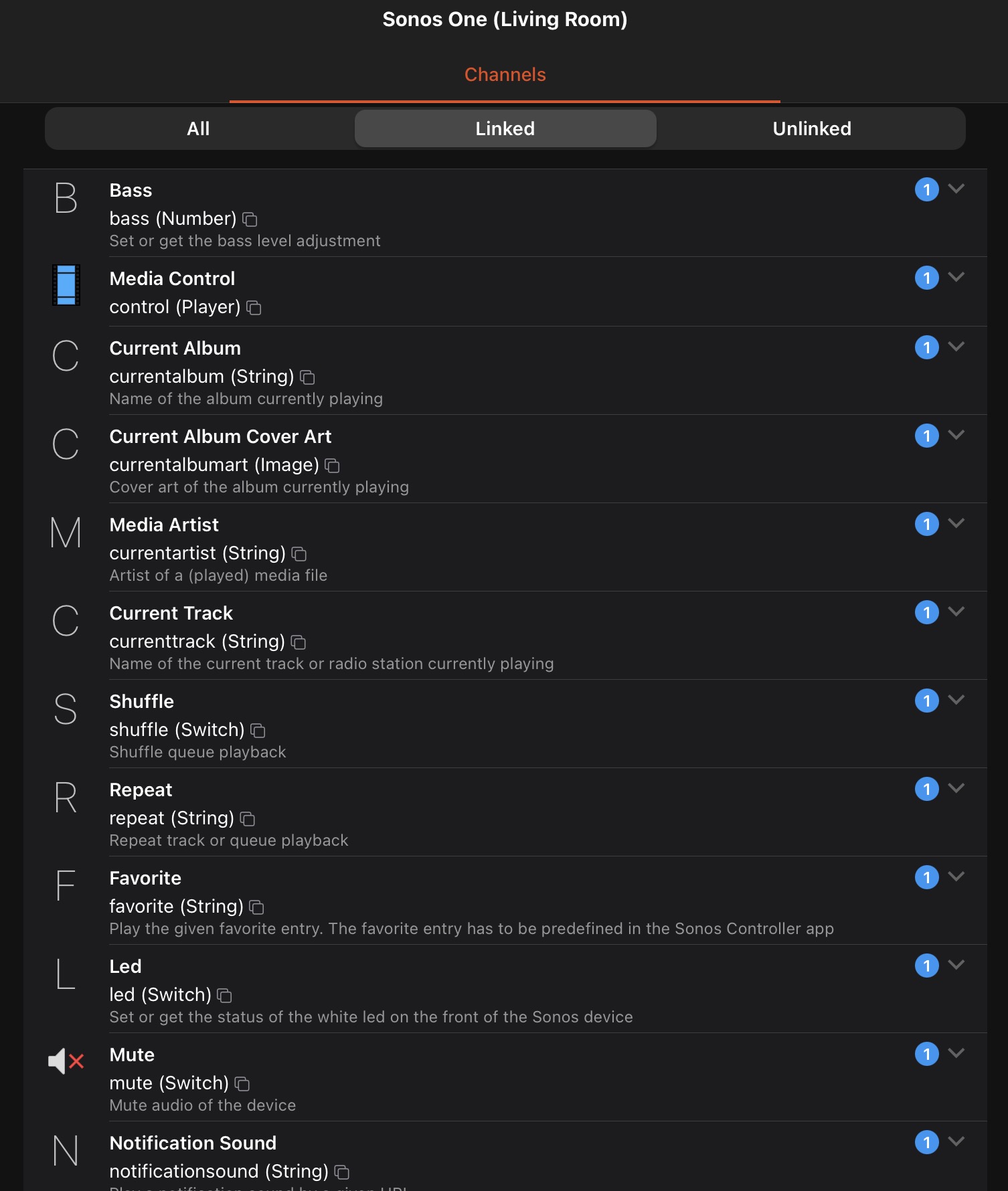

The Sonos One thing is configured on the MainUI, and it’s online. I have deleted and added it back, but nothing has changed. I had not previously defined any Notification Sound Volume, but setting it to 30 didn’t change the fact that no notifications are played.
Most channels are connected to an item.
On the Sonos App, UnPn is ON. I tried changing the Authentication setting from OFF to ON, but nothing changed.

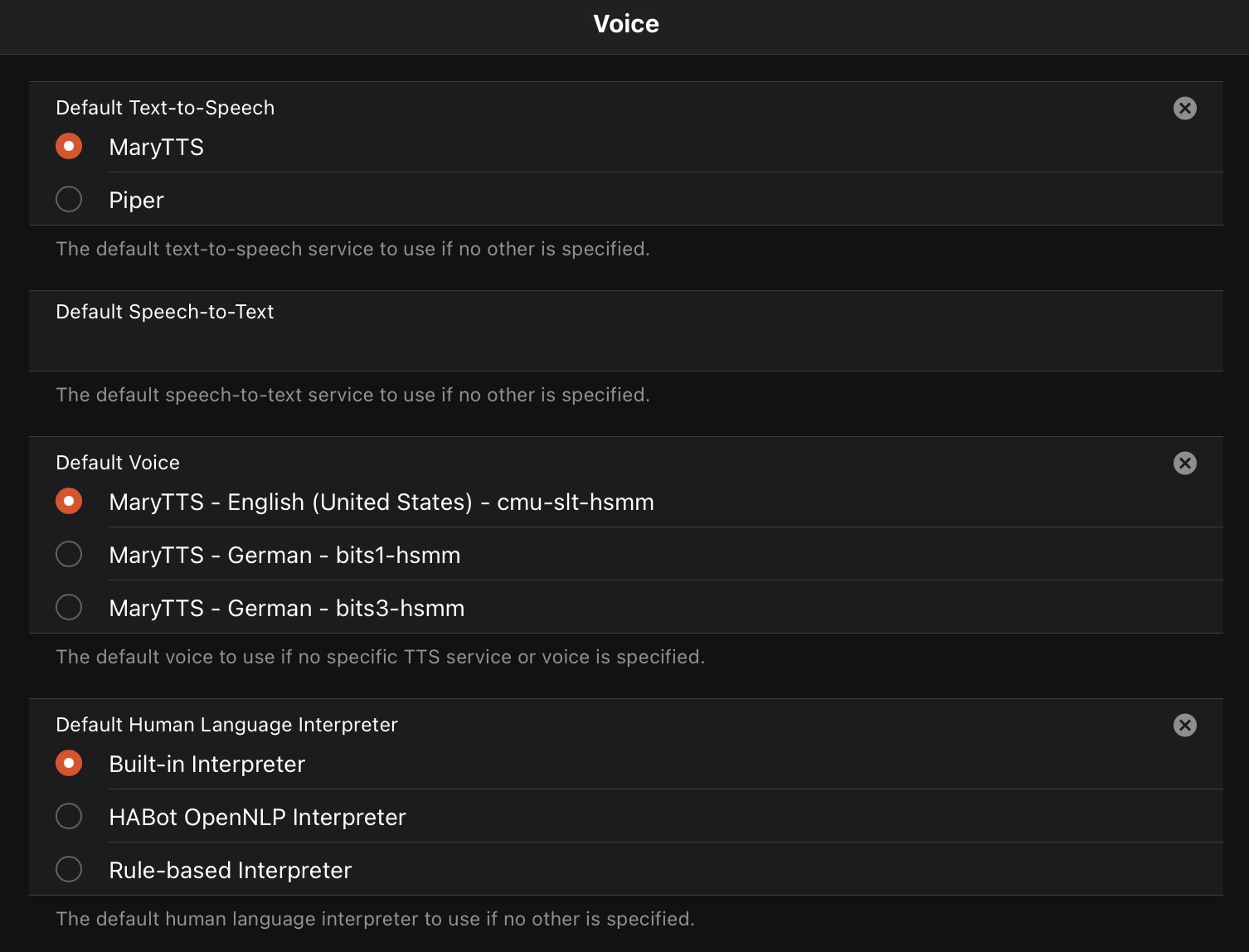

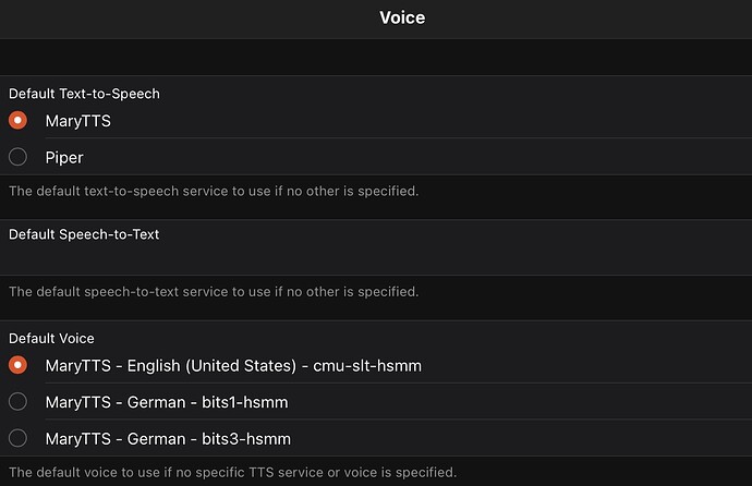

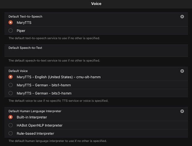

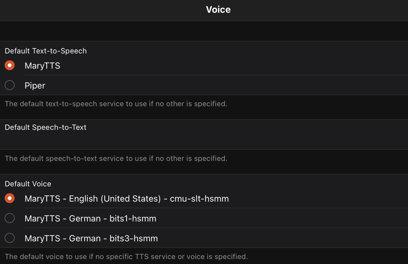

Voice
I have been using MaryTTS for 3 or 4 years now. Sometimes, when the default voice gets lost after an upgrade, notifications stop working, but after resetting it, they start working again. However, with this upgrade, nothing got lost.

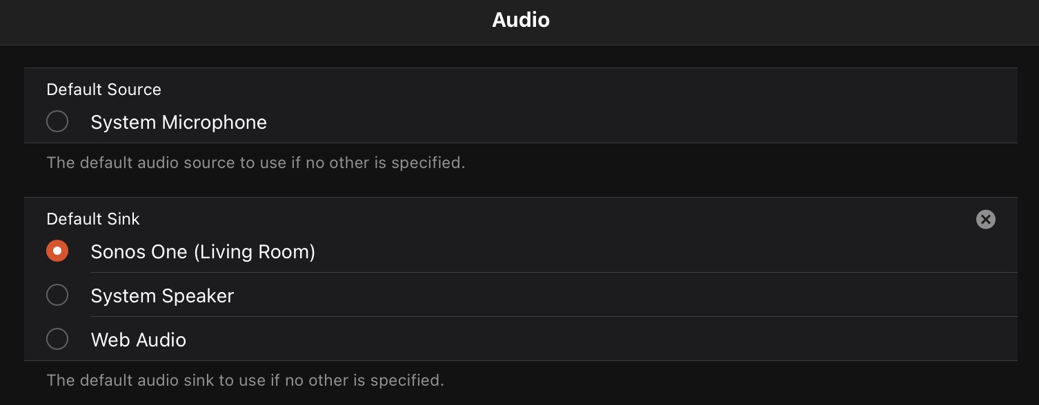

Audio
The default sink is the Sonos One.

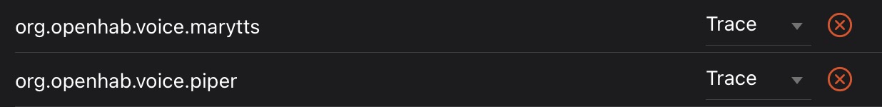

The logging level of MaryTTS is Trace, but nothing is logged. I have also tried with Piper with model pre-loading, but nothing gets logged or spoken either.

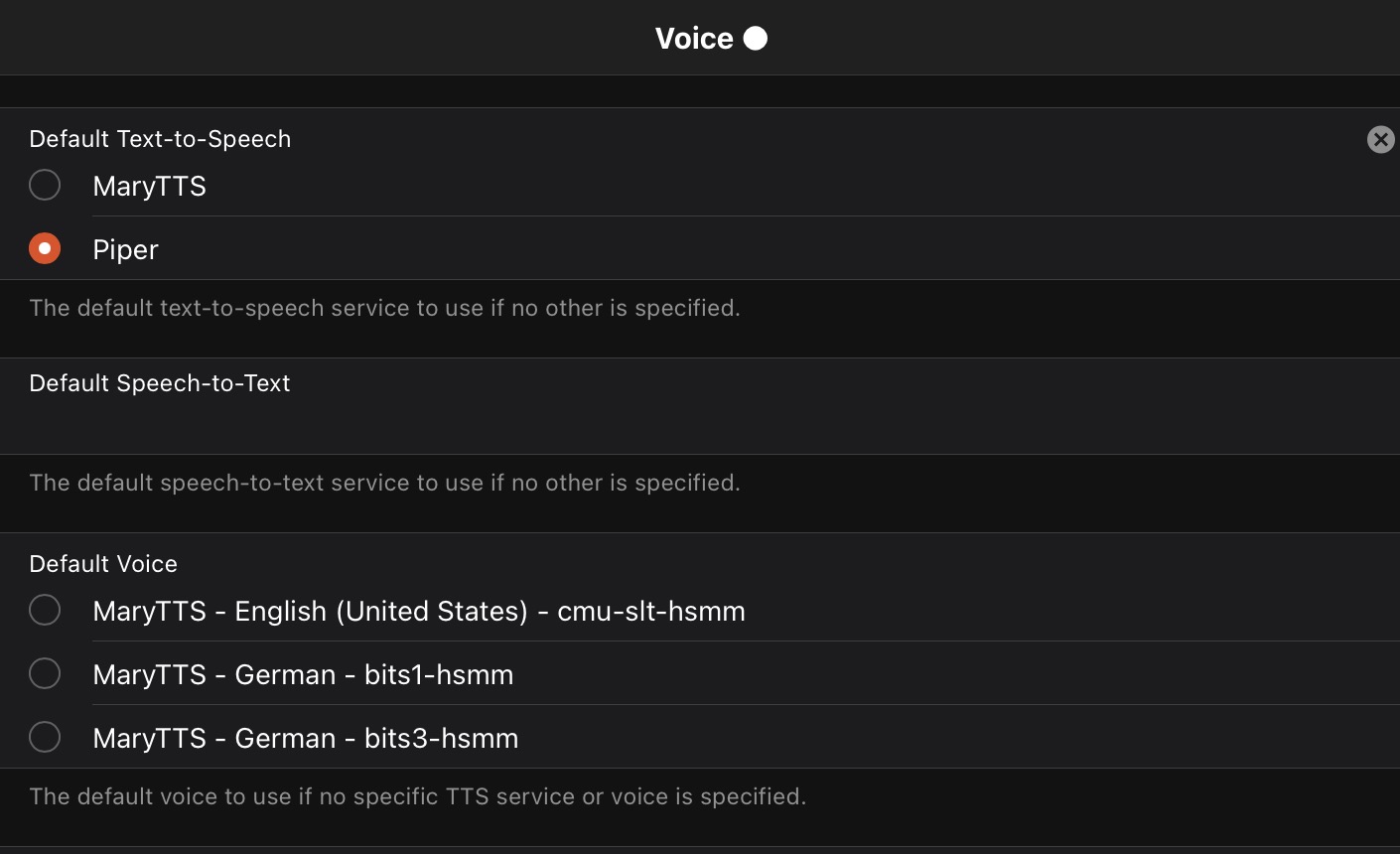

The Sonos speaker is ONLINE, and when I select Piper instead of Mary as the default TTS, nothing changes.

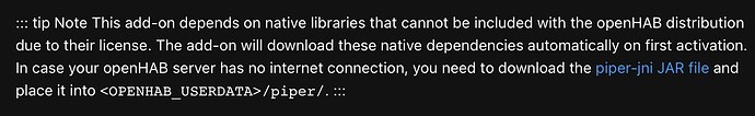

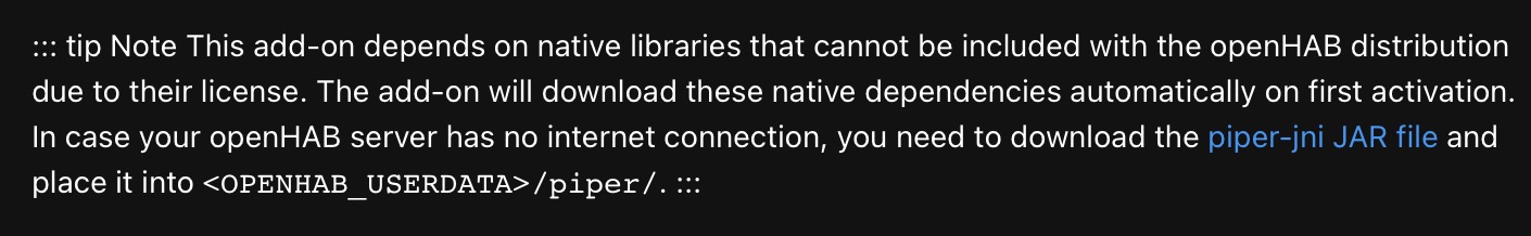

With Piper you also need to separately download the voices and select the default voice to use.
I thought I read that it would download the libraries automatically when connected to the internet.
Downloading Voice Model Files
You can find an overview of the available voices on GitHub (opens new window).
Each voice model is composed of two files: an ONNX runtime model file with extension .onnx and a model config file with extension .onnx.json. For the add-on to load your voices, the two files must have the same base filename (differing only in their extensions).
You should place both voice files at ‘<OPENHAB_USERDATA>/piper/’. After that, Main UI should display your available voices at Settings / System Settings / Voice.

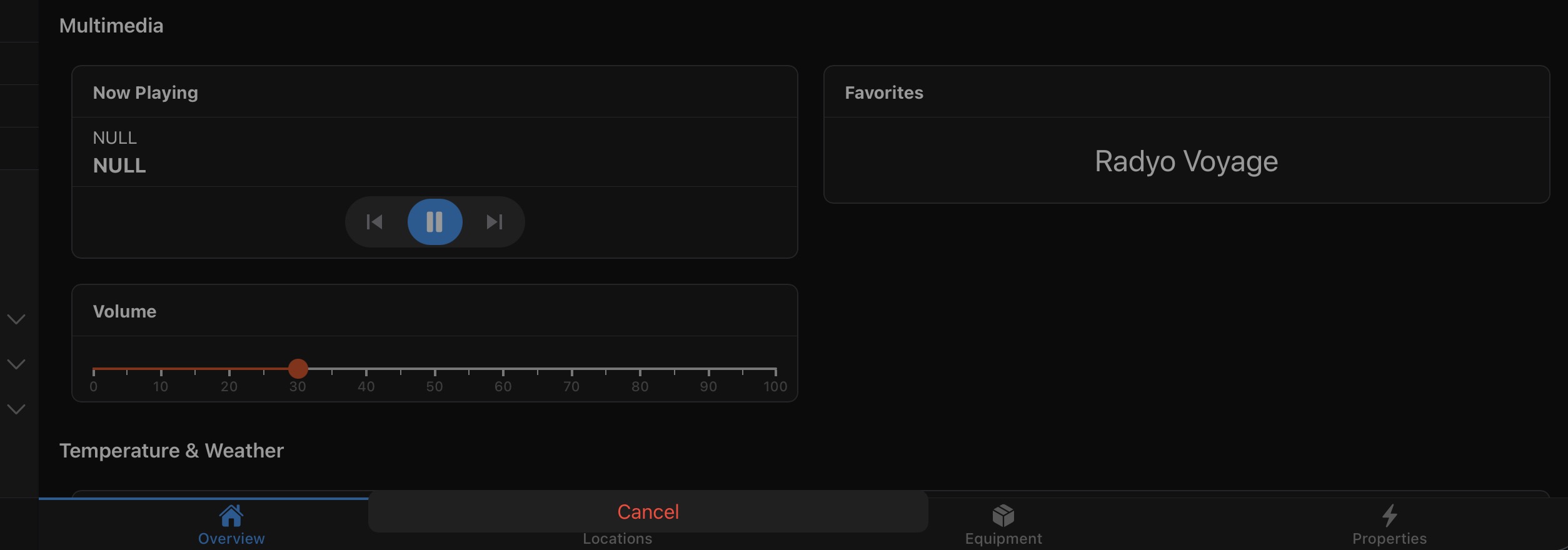

Update about Sonos: I can finally see the list of favorites and info on what’s playing. I guess it’s safe to discard Sonos as the problem.
So I downloaded one of the voices and uploaded the 2 files to the /var/lib/openhab/piper/ folder, as mentioned in the instructions
[home-automator@localhost piper]$ ls
en_US-amy-medium.onnx  en_US-amy-medium.onnx.json  lib-1.4.2  piper-jni-1.4.2.jar
The piper-jni file was already there. I went to Settings > System Settings → Voice and selected Piper, but it still doesn’t find the voices:
08:49:35.147[DEBUG] [org.openhab.voice.pipertts.internal.PiperTTSService] - bundle org.openhab.voice.pipertts:5.2.1 (332)[org.openhab.voice.pipertts.internal.PiperTTSService(483)] : dm $000 tracking 4 SingleStatic modified {org.openhab.core.voice.TTSCache}={service.id=518, service.bundleid=228, service.scope=bundle, osgi.ds.satisfying.condition.target=(osgi.condition.id=true), felix.fileinstall.filename=file:/var/lib/openhab/etc/org.openhab.voice.cfg, defaultTTS=marytts, defaultHLI=system, service.pid=org.openhab.voice, component.name=org.openhab.core.voice.internal.cache.TTSLRUCacheImpl, component.id=349} (enter)
08:49:35.149[DEBUG] [org.openhab.voice.pipertts.internal.PiperTTSService] - bundle org.openhab.voice.pipertts:5.2.1 (332)[org.openhab.voice.pipertts.internal.PiperTTSService(483)] : dm $000 tracking 4 SingleStatic modified {org.openhab.core.voice.TTSCache}={service.id=518, service.bundleid=228, service.scope=bundle, osgi.ds.satisfying.condition.target=(osgi.condition.id=true), felix.fileinstall.filename=file:/var/lib/openhab/etc/org.openhab.voice.cfg, defaultTTS=marytts, defaultHLI=system, service.pid=org.openhab.voice, component.name=org.openhab.core.voice.internal.cache.TTSLRUCacheImpl, component.id=349} (exit)
08:49:35.159[DEBUG] [org.openhab.voice.pipertts.internal.PiperTTSService] - Available number of piper voices: 0

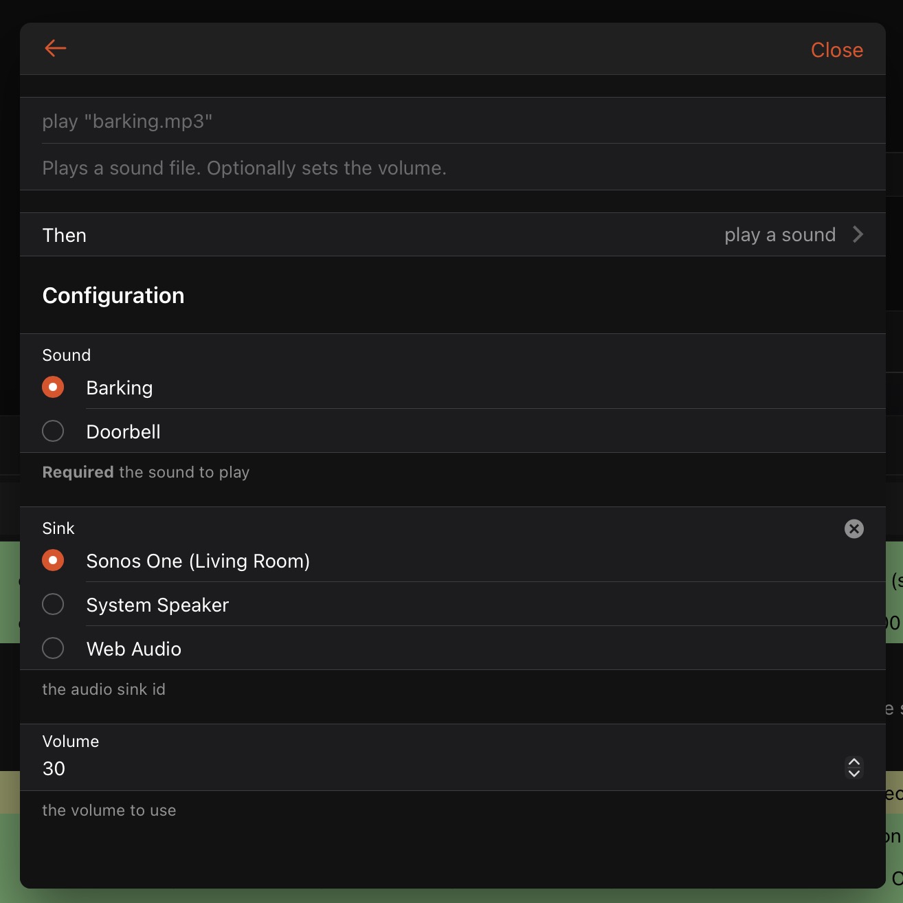

Can you send it an MP3 or WAV file from a rule?

The only issues I ever had with the sonos binding all relate to the fact that I run OH in a docker container and docker doesn’t play well with jupnp so there’s a lot of massaging of extra jupnp settings to get everything to talk to each other. That shouldn’t be a problem just running on an rPI. That said, the unidirectional communication (oh → sonos OK, but sonos → oh not), looks a lot like some of those jupnp symptoms.
Do you have more than one network interface on that rPI? That’s one of the thing that trips up sonos’s jupnp connections.

@JustinG, no, it’s connected via an Ethernet cable only.

@rlkoshak, I created a test rule on Main UI
The rule plays; it doesn’t produce any error; nothing is played on the speaker either, and no error gets logged; then the speaker plays back whatever it was playing before.
09:01:37.122[INFO] [openhab.event.RuleUpdatedEvent] - Rule 'test2' has been updated.
09:05:05.733[DEBUG] [org.openhab.binding.sonos.internal.SonosAudioSink] - Audio stream accessible through HTTP served at /audio/796a11ee-XXXX-XXXX-XXXX-XXXXXXXXXXXX for Sonos playback
09:05:05.734[DEBUG] [org.openhab.binding.sonos.internal.handler.ZonePlayerHandler] - playNotificationSoundURI: notificationURL http://10.18.18.124:8080/audio/796a11ee-XXXX-XXXX-XXXX-XXXXXXXXXXXX.mp3 currentURI x-sonos-vli:RINCON_48A6B8D01XXXXXXXX:2,spotify:d2b6a8d78fa3558150335cbd595c7c42 metadata <DIDL-Lite xmlns:dc="http://purl.org/dc/elements/1.1/" xmlns:upnp="urn:schemas-upnp-org:metadata-1-0/upnp/" xmlns:r="urn:schemas-rinconnetworks-com:metadata-1-0/" xmlns="urn:schemas-upnp-org:metadata-1-0/DIDL-Lite/"><item id="spotify" parentID="0" restricted="false"><dc:title>Spotify</dc:title><upnp:class>object.item.audioItem.linein</upnp:class><res protocolInfo="x-sonos-vli:*:audio:*">x-sonos-vli:RINCON_48A6B8D01XXXXXXXX:2,spotify:d2b6a8d78fa3558150335cbd595c7c42</res><vli cookie="10" group=""></vli></item></DIDL-Lite>
09:05:05.735[DEBUG] [org.openhab.binding.sonos.internal.handler.ZonePlayerHandler] - Handling notification while virtual line-in is playing or last played
09:05:05.736[DEBUG] [org.openhab.binding.sonos.internal.handler.ZonePlayerHandler] - handleNotificationSound: URL http://10.XX.XX.XXX:8080/audio/796a11ee-XXXX-XXXX-XXXX-XXXXXXXXXXXX.mp3 coordinator RINCON_48A6B8D01XXXXXXXX
09:05:05.738[DEBUG] [org.openhab.binding.sonos.internal.handler.ZonePlayerHandler] - Stop current playback...
09:05:05.746[DEBUG] [org.openhab.binding.sonos.internal.handler.ZonePlayerHandler] - Current playback stopped
09:05:05.747[DEBUG] [org.openhab.binding.sonos.internal.handler.ZonePlayerHandler] - Apply notification volume
09:05:05.760[DEBUG] [org.openhab.binding.sonos.internal.handler.ZonePlayerHandler] - Add notification URI http://10.XX.XX.XXX:8080/audio/796a11ee-XXXX-XXXX-XXXX-XXXXXXXXXXXX.mp3 to queue
09:05:05.768[DEBUG] [org.openhab.binding.sonos.internal.handler.ZonePlayerHandler] - Set current URI to x-rincon-queue:RINCON_48A6B8D01XXXXXXXX#0
09:05:05.769[DEBUG] [org.openhab.binding.sonos.internal.handler.ZonePlayerHandler] - setCurrentURI URI x-rincon-queue:RINCON_48A6B8D01XXXXXXXX#0 URIMetaData
09:05:05.842[DEBUG] [org.openhab.binding.sonos.internal.handler.ZonePlayerHandler] - Set track position to 1
09:05:05.849[DEBUG] [org.openhab.binding.sonos.internal.handler.ZonePlayerHandler] - Start notification playback...
09:05:14.460[DEBUG] [org.openhab.binding.sonos.internal.handler.ZonePlayerHandler] - Polling job
09:05:25.938[DEBUG] [org.openhab.binding.sonos.internal.handler.ZonePlayerHandler] - Notification playback ended
09:05:25.940[DEBUG] [org.openhab.binding.sonos.internal.handler.ZonePlayerHandler] - Restore original volume 30
09:05:25.956[DEBUG] [org.openhab.binding.sonos.internal.handler.ZonePlayerHandler] - Remove notification track from queue
09:05:25.964[DEBUG] [org.openhab.binding.sonos.internal.handler.ZonePlayerHandler] - Restoring sound from virtual line-in using URI x-sonos-vli:RINCON_48A6B8D01XXXXXXXX:2,spotify:d2b6a8d78fa3558150335cbd595c7c42 and metadata <DIDL-Lite xmlns:dc="http://purl.org/dc/elements/1.1/" xmlns:upnp="urn:schemas-upnp-org:metadata-1-0/upnp/" xmlns:r="urn:schemas-rinconnetworks-com:metadata-1-0/" xmlns="urn:schemas-upnp-org:metadata-1-0/DIDL-Lite/"><item id="spotify" parentID="0" restricted="false"><dc:title>Spotify</dc:title><upnp:class>object.item.audioItem.linein</upnp:class><res protocolInfo="x-sonos-vli:*:audio:*">x-sonos-vli:RINCON_48A6B8D01XXXXXXXX:2,spotify:d2b6a8d78fa3558150335cbd595c7c42</res><vli cookie="10" group=""></vli></item></DIDL-Lite>
09:05:25.964[DEBUG] [org.openhab.binding.sonos.internal.handler.ZonePlayerHandler] - setCurrentURI URI x-sonos-vli:RINCON_48A6B8D01XXXXXXXX:2,spotify:d2b6a8d78fa3558150335cbd595c7c42 URIMetaData <DIDL-Lite xmlns:dc="http://purl.org/dc/elements/1.1/" xmlns:upnp="urn:schemas-upnp-org:metadata-1-0/upnp/" xmlns:r="urn:schemas-rinconnetworks-com:metadata-1-0/" xmlns="urn:schemas-upnp-org:metadata-1-0/DIDL-Lite/"><item id="spotify" parentID="0" restricted="false"><dc:title>Spotify</dc:title><upnp:class>object.item.audioItem.linein</upnp:class><res protocolInfo="x-sonos-vli:*:audio:*">x-sonos-vli:RINCON_48A6B8D01XXXXXXXX:2,spotify:d2b6a8d78fa3558150335cbd595c7c42</res><vli cookie="10" group=""></vli></item></DIDL-Lite>
09:06:14.472[DEBUG] [org.openhab.binding.sonos.internal.handler.ZonePlayerHandler] - Polling job

And still, I can’t see the uploaded voices for Piper
Even though the files are in the folder mentioned in the documentation:
[home-automator@localhost ~]$ cd /var/lib/openhab/piper/
[home-automator@localhost piper]$ ls -l
total 173512
-rw-r--r--. 1 openhab openhab 63201294 Aug 31 15:23 en_US-amy-medium.onnx
-rw-r--r--. 1 openhab openhab 63201294 Aug 31 15:23 en_US-amy-medium.onnx.json
drwxrwxr-x. 3 openhab openhab     4096 Aug 23 12:42 lib-1.4.2
-rwxrwxr-x. 1 openhab openhab 51248147 Aug 23 12:42 piper-jni-1.4.2.jar
I’ve set the org.openhab.voice.piper logger to TRACE, but all it logs is
09:30:03.136[DEBUG] [org.openhab.voice.pipertts.internal.PiperTTSService] - Available number of piper voices: 0
Unless and until that line says something more than 1 piper isn’t going to work. But it’s not clear why it wouldn’t work. Everything looks correct and I have no ideas. When I followed the instructions it just worked. I have no actual debugging experience with the voice subsystem. The fact that neither MaryTTS nor Piper work might be meaningful, might not be.
