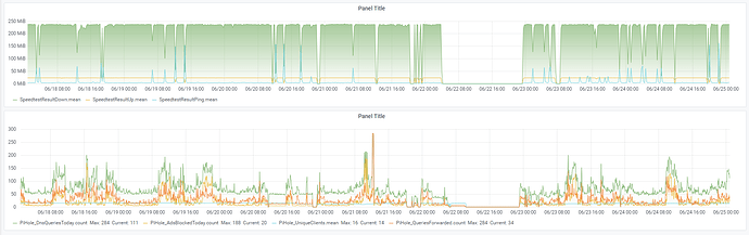

It brakes few times .
following chart all break point are break point due to Speed test failure in last 7 days(except the big one) . Big one is due to recharge for services pending from my side .
1st chart is for speed test and 2nd one is Pi hole
Yes I have similar setup :slight_smile:
I know now if it was really an outage, you can usually see a really big increase on the Pi-hole graph as all devices retries to connect to its web services :slight_smile:
Anyway I’m happy with this right now, it can detect internet outage 95% correctly…
