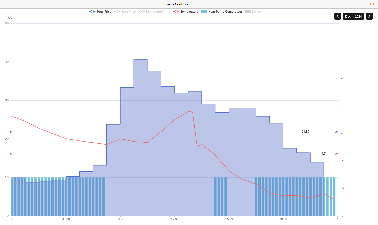

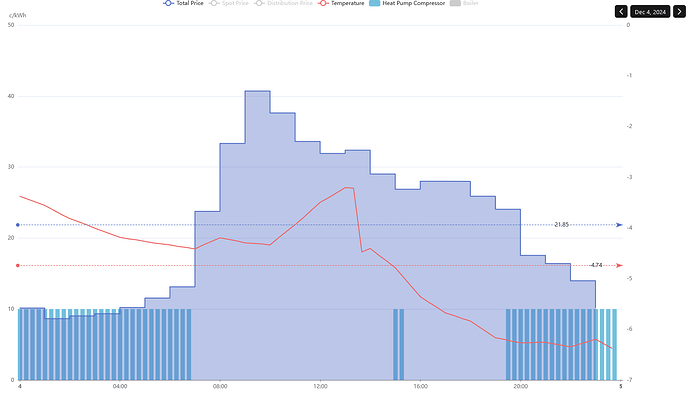

The result of this hypothetical example situation would look like this:
Heating control points before are illustrated in the figure below.
  • I use periodOverlap to be 1 hour.
  • All of the heating need of the 05:00 - 13:00 period takes place in the beginning of this period
  • The non-flexible heating need for the period 11:00-19:00 is 1h 30 minutes. 30 minutes of this take place at 15:00 and the rest happen at the end of this period starting at 19:30 (the gap shifting feature postponed this heating slightly so that’s why it starts this late)
The ExtraHeatingOptimization Rule was optimizing just the period from 15:00 - 21:00. With the example parameters illustrated above, the result looks like this:
  • There is 30 minutes more heating starting at 15:00
  • And then the heating goes on at 18:00 instead of 19:30
