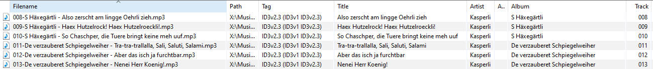

I first I thought the problem was related to all the “öäü” in the ID3Tag due to the German language. However this was not the case. But I found a place in the playlist where the update failed:
When I’ve loaded this playlist (see picture) the jump from Track 10 to 11 fails. So the title and Album etc are updated for the tracks 1 to 10 but once the “new” album starts it fails to update the Album and Artist
Also in the log you can see that the Name of the Album gets set to “” the same for the Artist
