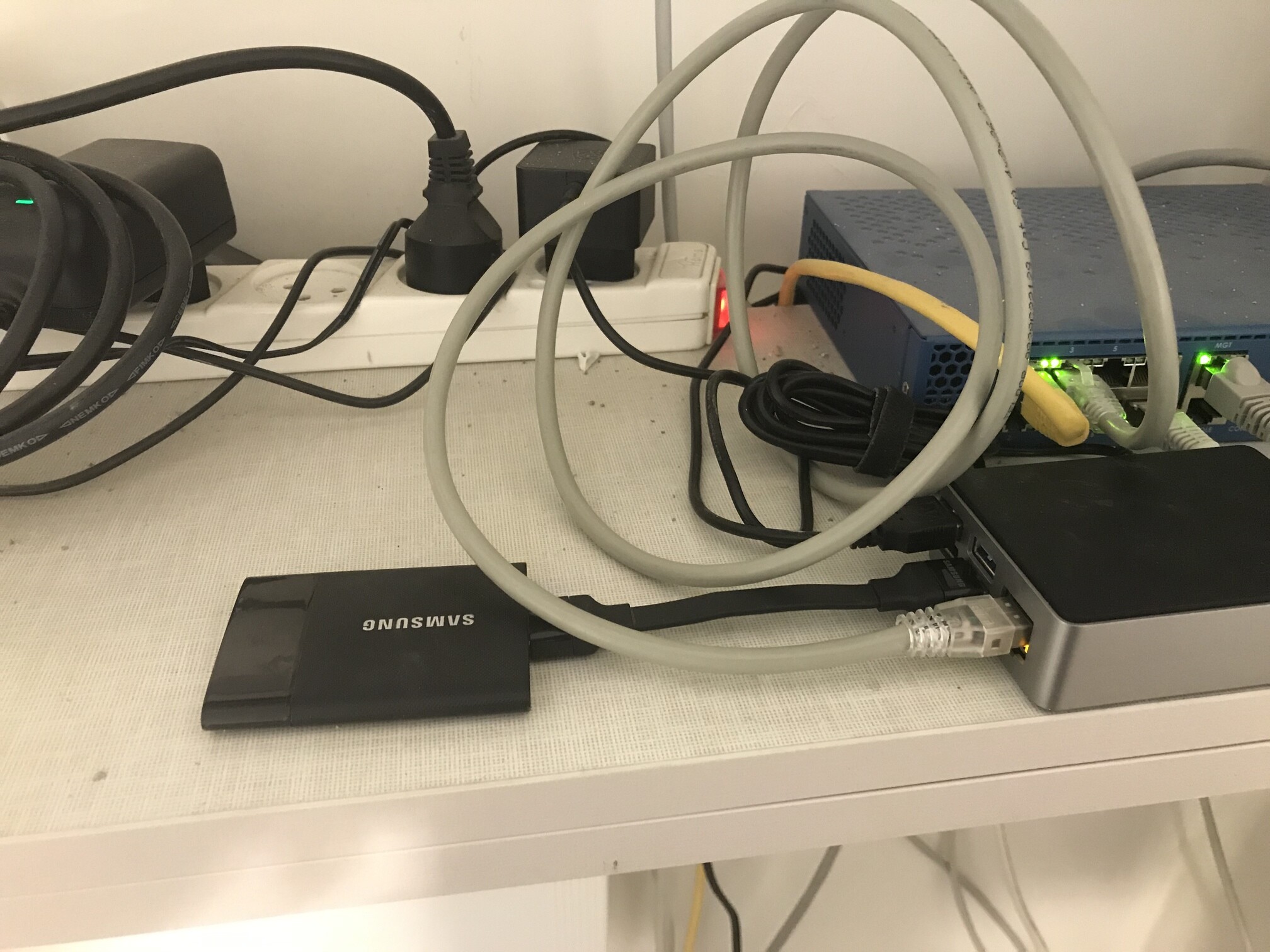

Been using SSD on my RPi4 to host docker based deployment.
Since yesterday I keep seeing weird errors which remind me the days of SD card issues.
Can it be? It’s running for a year now
Can I check SSD for errors that will effect this?
And most importantly, can the errors below be a result of bad config? I do regularly updates.
