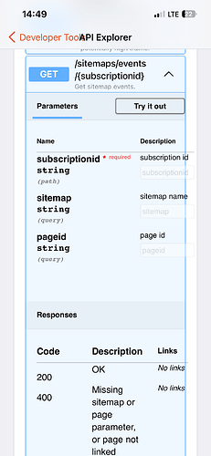

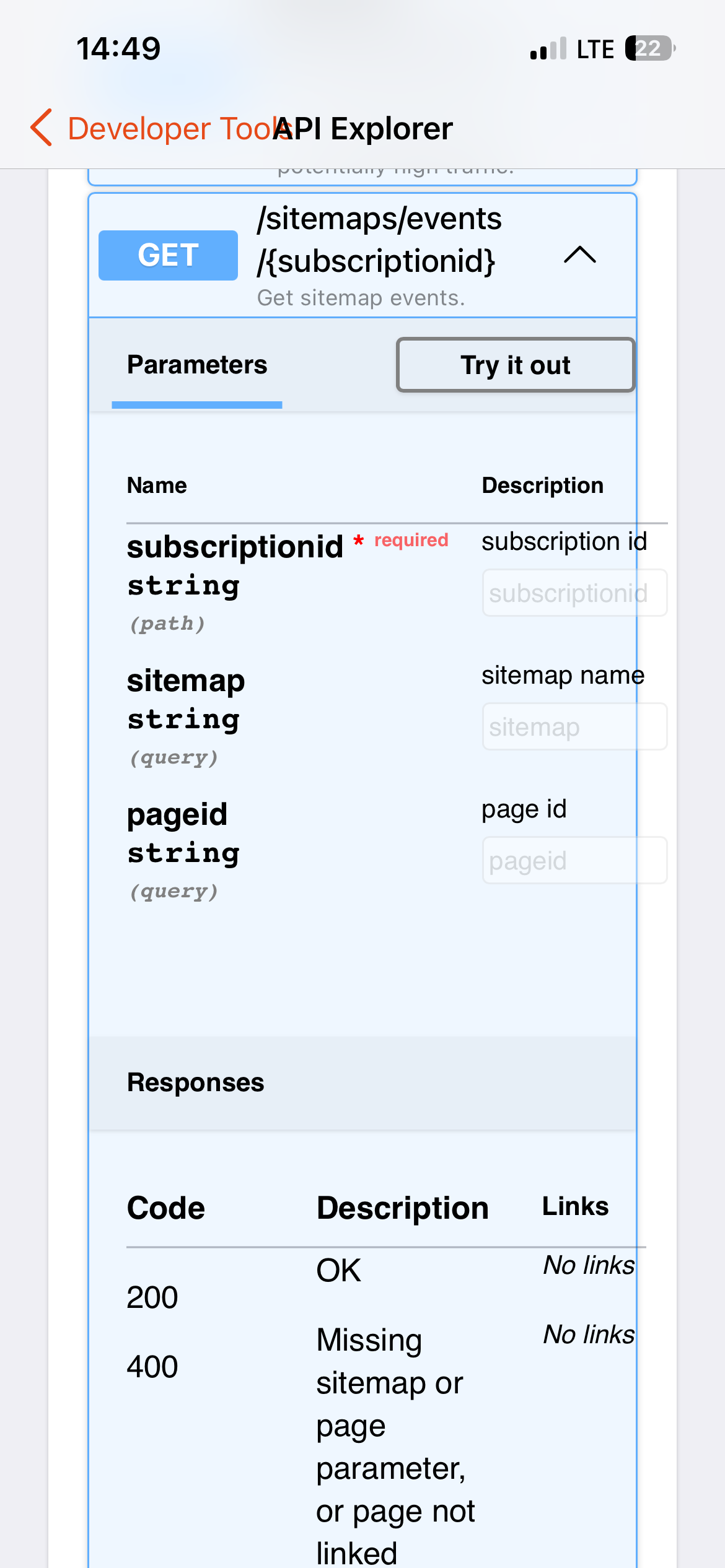

You need to provide the Sitemap name and the pageId as query params, the API Explorer in Main UI also shows this:
