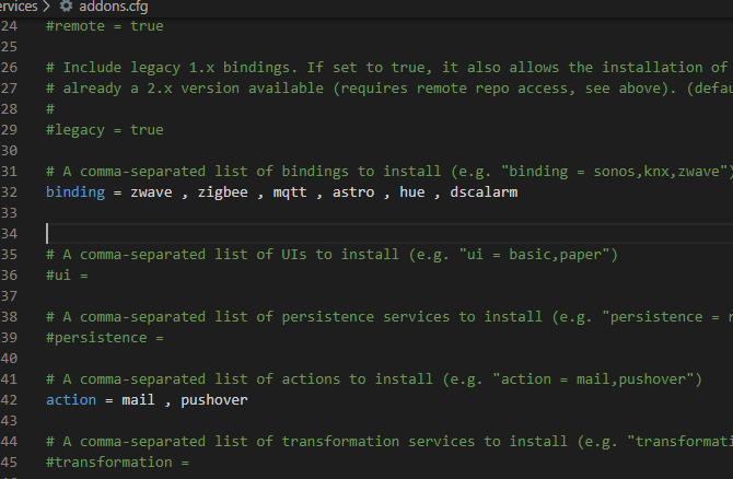

I added a screen shot of my addons along with the logs. Looks like zigbee which i’m not using is causing an error. i WILL remove zigbee to see if this helps.

You can also see the offending mail action in there as well. Be smart to remove that, too?
That is the addons.cfg
file in the configuration directory that us usually all commented out. The addons,config
file is where openHAB stores its configuration somewhere under userdata

EDIT@:There is a new v2 mail binding so you need to enable the legacy addons to enable the old one. This is documented in the Release Notes for 2.5. The publish them in the announcements so people can avoid issues.
I believe you upgraded from an earlier version to 2.5 and ran into the issues with the mail binding and the restdocs.
My system was behaving exactly like this (Zwave going from online to offline constantly) until I made the changes that were announced during the upgrade process as well as in the changelog (change location of Restdocs, disable mail binding, both in addons.cfg)

I really appreciate you taking the time to help me with my problem. I removed the mail addon, realized I wasn’t using it. I didn’t have restdocs installed in misc.
