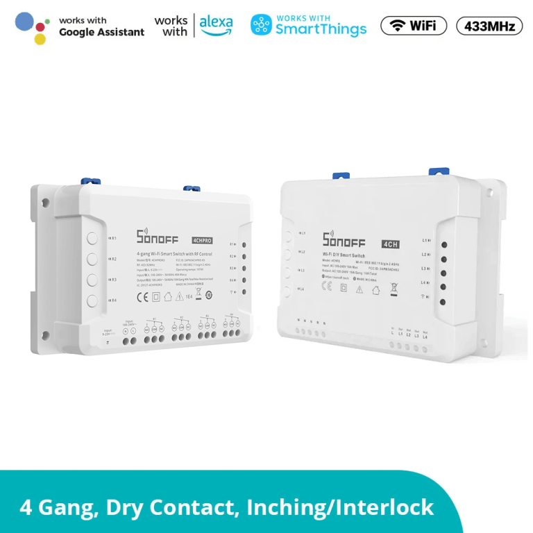

Is there any cheap and easy alternative for switching some relais (ca. 10) on and off with openHAB?
Maybe some of this:
I would only switch relais, not directly connected to the power circuit. Because there are some problems with exploding sonoff switches - bad soldering - not enough for high loads.
But if you only want to switch relais, there should be no cheaper way without soldering it by yourself.
Okay, and this product can be connected to openHAB?
Edit: And by the way. It doesn’t depend on a few Euros…
You can search in this forum for sonoff. You have to flash the sonoff devices with tasmota firmware and so you can control it with openhab and mqtt.
You don´t need any gateway, it is working with wifi.
Is there anything similar with ethernet connector?
Maybe with a raspi and a 10-channel relais board?
