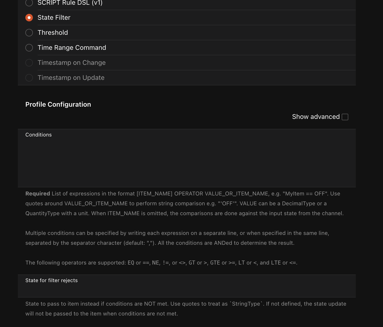

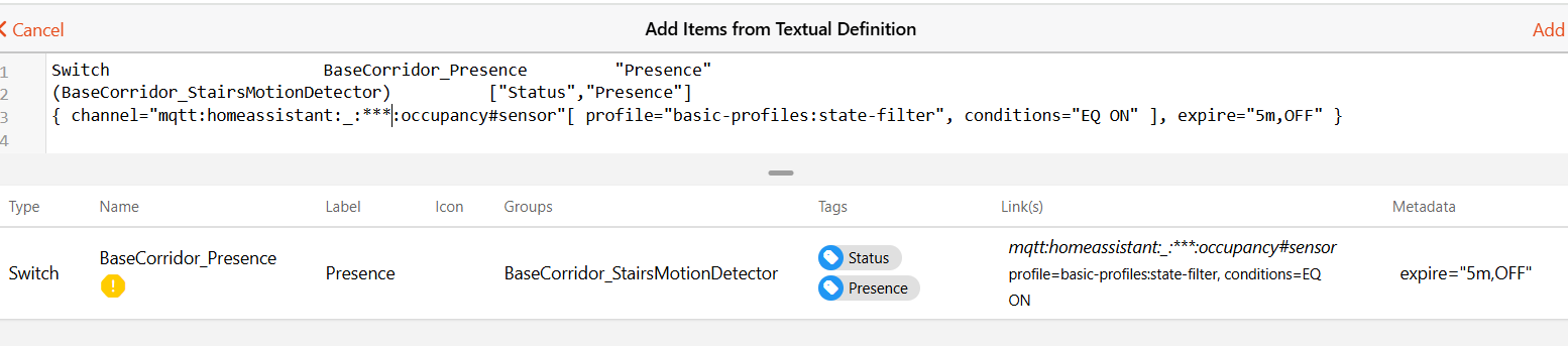

Hello, I’m trying to use the State Filter profile in order to extend the Keep Time of a motion detector. Basically, I’m trying to filter out all OFF state updates of a Motion Detector sensor (The Motion Detectors trigger ON on motion, but go back to ‘OFF’ after a short (random or preset) time, if no new motion is detected). I would like to ignore that ‘OFF’ update and replace it by an ‘OFF’ update after say - 15 minutes - with no motion detection.
Switch BaseCorridor_Presence "Presence" (BaseCorridor_StairsMotionDetector) ["Status","Presence"] { channel="mqtt:homeassistant:_:...:occupancy#sensor"[ profile="basic-profiles:state-filter", conditions="EQ ON" ], expire="5m,OFF" }
When I configure this within the UI, starting from the channel, creating a link to a new/existing item, I can configure the condition(s). When I try to do this in the posted format via the “Add Items From Textual Definitions” screen, it will accep the syntax ..
But the creation still fails… the state never updates and when I try to manually edit the profile condition from the appropriate dialogue, the “conditions” box has disappeared …
Seems like a small bug to me?
This sounds like possibly a bug in the “Add items from textual definitions” process, not in the profile itself.
I tried this too but can’t reproduce the problem though. When I pasted your text definition, I got an error, but the item got created without a link. When I tried to manually add a link it seemed to work fine.
