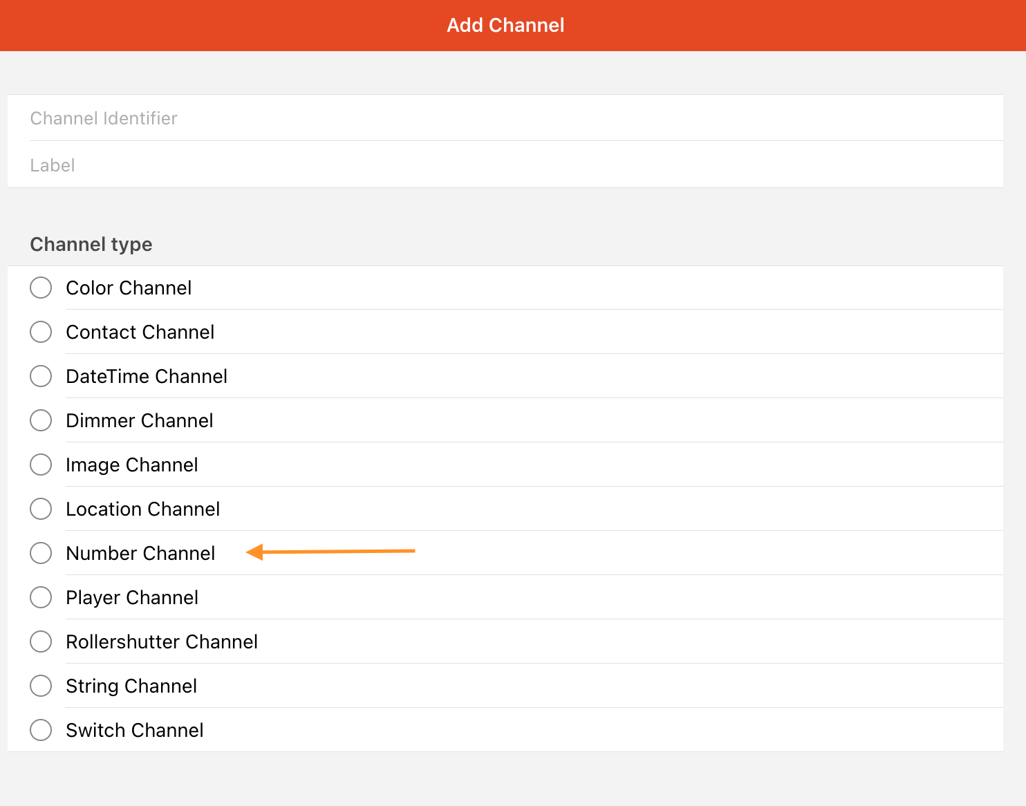

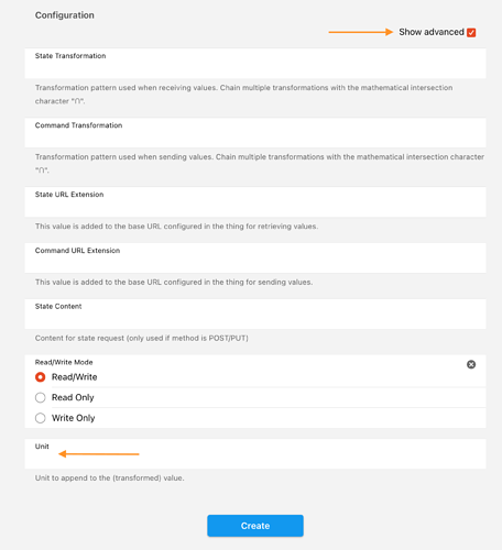

you are absolutely right, I reconfigured and it works like charm,
My problem was that I originally made a string channel and made transfomation while linking to item.
What I had to do and what works, to implement transformtion in channel (making number channel and putting unit there). And then linking does no transformation.
