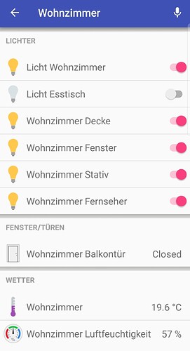

All switch were on and I just pressed the upper switch. It’s the group containing all other switch below. Right after pressing the button it switches back on and the screen remains as follows.
Thus all lights go off

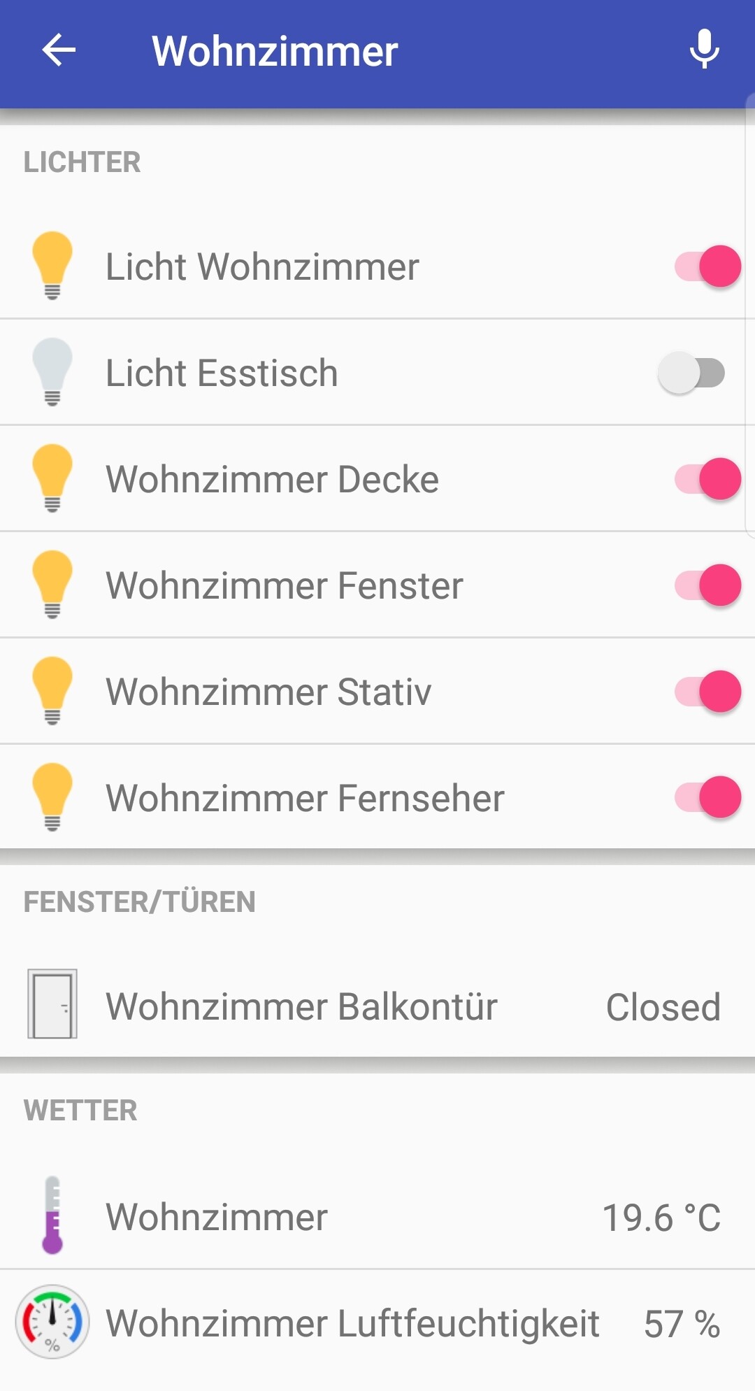

Hi, thanks for helping further troubleshooting…
but in in my case the problem is not a chart. it is the visibility status from items in the sitemap…
just to be sure we are talking about the same thing 😉
updated the android app on one client and here are the logs as requested…
openhab log:
```csv
2018-12-22 04:57:17.040 [DEBUG] [.binding.knx.internal.bus.KNXBinding] - Received groupWrite Event.
2018-12-22 04:57:17.041 [ome.event.ItemCommandEvent] - Item 'EG_KNX_Wohnzimmer_Essplatz_Licht' received command ON
2018-12-22 04:57:17.145 [DEBUG] [.binding.knx.internal.bus.KNXBinding] - Received groupWrite Event.
2018-12-22 04:57:17.146 [DEBUG] [.sitemap.internal.SitemapEventOutput] - Sent sitemap event for widget 030011 to subscription 688fb518-a157-4806-99b1-6b1bf363ff94.
2018-12-22 04:57:17.146 [DEBUG] [.sitemap.internal.SitemapEventOutput] - Sent sitemap event for widget 030011 to subscription 79d9b21e-470f-4b38-8bc8-415f9fd9111a.
2018-12-22 04:57:17.147 [DEBUG] [.sitemap.internal.SitemapEventOutput] - Sent sitemap event for widget 030011 to subscription 4a13754a-8366-44e6-b731-c3ce361713be.
2018-12-22 04:57:17.148 [DEBUG] [est.sitemap.internal.SitemapResource] - SSE connection for subscription 742031ce-272e-4d58-b27c-f7d68b89fa49 has been closed.
2018-12-22 04:57:17.148 [DEBUG] [t.sitemap.SitemapSubscriptionService] - Removed subscription with id 742031ce-272e-4d58-b27c-f7d68b89fa49 (7 active subscriptions)
2018-12-22 04:57:17.149 [vent.ItemStateChangedEvent] - EG_KNX_Wohnzimmer_Essplatz_Licht changed from OFF to ON
2018-12-22 04:57:17.150 [DEBUG] [.sitemap.internal.SitemapEventOutput] - Sent sitemap event for widget 030011 to subscription 1cedb4cf-939c-41dc-908c-369dd0f1ac8b.
2018-12-22 04:57:17.235 [DEBUG] [est.sitemap.internal.SitemapResource] - Received HTTP GET request from IP 192.168.0.198 at 'sitemaps/home/0300'
2018-12-22 04:57:17.359 [DEBUG] [est.sitemap.internal.SitemapResource] - Received HTTP GET request from IP 192.168.0.171 at 'sitemaps/home/0300'
2018-12-22 04:57:17.452 [DEBUG] [est.sitemap.internal.SitemapResource] - Received HTTP GET request from IP 192.168.0.194 at 'sitemaps/home/0300'
2018-12-22 04:57:17.472 [DEBUG] [est.sitemap.internal.SitemapResource] - Received HTTP GET request from IP 192.168.0.194 at 'sitemaps/home/0300'
2018-12-22 04:57:18.362 [DEBUG] [est.sitemap.internal.SitemapResource] - Received HTTP GET request from IP 192.168.0.167 at 'sitemaps/home/home'
2018-12-22 04:57:21.373 [DEBUG] [.binding.knx.internal.bus.KNXBinding] - Received groupWrite Event.
2018-12-22 04:57:21.374 [ome.event.ItemCommandEvent] - Item 'EG_KNX_Wohnzimmer_Essplatz_Licht' received command OFF
2018-12-22 04:57:21.429 [DEBUG] [t.sitemap.SitemapSubscriptionService] - Subscription 700f7f7b-1fee-403f-9ff0-1da57d847b95 changed to page home of sitemap home (7 active subscriptions}
2018-12-22 04:57:21.429 [DEBUG] [est.sitemap.internal.SitemapResource] - Client from IP 192.168.0.198 requested sitemap event stream for subscription 700f7f7b-1fee-403f-9ff0-1da57d847b95.
2018-12-22 04:57:21.448 [DEBUG] [.binding.knx.internal.bus.KNXBinding] - Received groupWrite Event.
2018-12-22 04:57:21.449 [DEBUG] [.sitemap.internal.SitemapEventOutput] - Sent sitemap event for widget 030011 to subscription 688fb518-a157-4806-99b1-6b1bf363ff94.
2018-12-22 04:57:21.449 [vent.ItemStateChangedEvent] - EG_KNX_Wohnzimmer_Essplatz_Licht changed from ON to OFF
2018-12-22 04:57:21.449 [DEBUG] [.sitemap.internal.SitemapEventOutput] - Sent sitemap event for widget 030011 to subscription 79d9b21e-470f-4b38-8bc8-415f9fd9111a.
2018-12-22 04:57:21.449 [DEBUG] [.sitemap.internal.SitemapEventOutput] - Sent sitemap event for widget 030011 to subscription 4a13754a-8366-44e6-b731-c3ce361713be.
2018-12-22 04:57:21.450 [DEBUG] [.sitemap.internal.SitemapEventOutput] - Sent sitemap event for widget 030011 to subscription 1cedb4cf-939c-41dc-908c-369dd0f1ac8b.
2018-12-22 04:57:21.595 [DEBUG] [est.sitemap.internal.SitemapResource] - Received HTTP GET request from IP 192.168.0.171 at 'sitemaps/home/0300'
2018-12-22 04:57:21.786 [DEBUG] [est.sitemap.internal.SitemapResource] - Received HTTP GET request from IP 192.168.0.198 at 'sitemaps/home/0300'
2018-12-22 04:57:21.804 [DEBUG] [est.sitemap.internal.SitemapResource] - Received HTTP GET request from IP 192.168.0.194 at 'sitemaps/home/0300'
2018-12-22 04:57:21.823 [DEBUG] [est.sitemap.internal.SitemapResource] - Received HTTP GET request from IP 192.168.0.194 at 'sitemaps/home/0300'

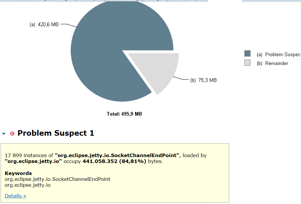

Good Morning,
just fyi … i have reduced my clients to only one permanent… current “symptoms”: system is getting slow and
commands are delayed… in the log i can find following entries for one command:
```csv
2018-12-24 07:00:34.144 [vent.ItemStateChangedEvent] - EG_KNX_Awc_Licht changed from ON to OFF
2018-12-24 07:00:34.145 [DEBUG] [.sitemap.internal.SitemapEventOutput] - Sent sitemap event for widget 030005 to subscription ad64ffc9-fe37-4289-8cc6-720451122d1e.
2018-12-24 07:00:34.145 [DEBUG] [.sitemap.internal.SitemapEventOutput] - Sent sitemap event for widget 030005 to subscription 9b88aedb-8602-40e7-9911-c5c9c6a8511f.
2018-12-24 07:00:34.145 [DEBUG] [.sitemap.internal.SitemapEventOutput] - Sent sitemap event for widget 030005 to subscription 7a224ea6-2d35-46aa-be14-ef75001ca9ce.
2018-12-24 07:00:34.145 [DEBUG] [.sitemap.internal.SitemapEventOutput] - Sent sitemap event for widget 030005 to subscription 4f3dc570-2e73-4b99-9145-e63aa3005fb2.
2018-12-24 07:00:34.146 [DEBUG] [.sitemap.internal.SitemapEventOutput] - Sent sitemap event for widget 030005 to subscription 9b88aedb-8602-40e7-9911-c5c9c6a8511f.
2018-12-24 07:00:34.146 [DEBUG] [.sitemap.internal.SitemapEventOutput] - Sent sitemap event for widget 030005 to subscription 7a224ea6-2d35-46aa-be14-ef75001ca9ce.
2018-12-24 07:00:34.146 [DEBUG] [.sitemap.internal.SitemapEventOutput] - Sent sitemap event for widget 030005 to subscription 4f3dc570-2e73-4b99-9145-e63aa3005fb2.
2018-12-24 07:00:34.146 [DEBUG] [.sitemap.internal.SitemapEventOutput] - Sent sitemap event for widget 030005 to subscription ad64ffc9-fe37-4289-8cc6-720451122d1e.
2018-12-24 07:00:34.147 [DEBUG] [.sitemap.internal.SitemapEventOutput] - Sent sitemap event for widget 030005 to subscription 7a224ea6-2d35-46aa-be14-ef75001ca9ce.
2018-12-24 07:00:34.147 [DEBUG] [.sitemap.internal.SitemapEventOutput] - Sent sitemap event for widget 030005 to subscription 4f3dc570-2e73-4b99-9145-e63aa3005fb2.
2018-12-24 07:00:34.147 [DEBUG] [.sitemap.internal.SitemapEventOutput] - Sent sitemap event for widget 030005 to subscription ad64ffc9-fe37-4289-8cc6-720451122d1e.
2018-12-24 07:00:34.147 [DEBUG] [.sitemap.internal.SitemapEventOutput] - Sent sitemap event for widget 030005 to subscription 9b88aedb-8602-40e7-9911-c5c9c6a8511f.
2018-12-24 07:00:34.148 [DEBUG] [.sitemap.internal.SitemapEventOutput] - Sent sitemap event for widget 030005 to subscription 7a224ea6-2d35-46aa-be14-ef75001ca9ce.
2018-12-24 07:00:34.148 [DEBUG] [.sitemap.internal.SitemapEventOutput] - Sent sitemap event for widget 030005 to subscription 4f3dc570-2e73-4b99-9145-e63aa3005fb2.
2018-12-24 07:00:34.148 [DEBUG] [.sitemap.internal.SitemapEventOutput] - Sent sitemap event for widget 030005 to subscription ad64ffc9-fe37-4289-8cc6-720451122d1e.
2018-12-24 07:00:34.148 [DEBUG] [.sitemap.internal.SitemapEventOutput] - Sent sitemap event for widget 030005 to subscription 9b88aedb-8602-40e7-9911-c5c9c6a8511f.
2018-12-24 07:00:34.897 [DEBUG] [t.sitemap.SitemapSubscriptionService] - Subscription 9b88aedb-8602-40e7-9911-c5c9c6a8511f changed to page 0300 of sitemap home (6 active subscriptions}
2018-12-24 07:00:34.897 [DEBUG] [est.sitemap.internal.SitemapResource] - Client from IP 192.168.0.194 requested sitemap event stream for subscription 9b88aedb-8602-40e7-9911-c5c9c6a8511f.
2018-12-24 07:00:35.850 [DEBUG] [t.sitemap.SitemapSubscriptionService] - Subscription ad64ffc9-fe37-4289-8cc6-720451122d1e changed to page 0300 of sitemap home (6 active subscriptions}
2018-12-24 07:00:35.850 [DEBUG] [est.sitemap.internal.SitemapResource] - Client from IP 192.168.0.194 requested sitemap event stream for subscription ad64ffc9-fe37-4289-8cc6-720451122d1e.
2018-12-24 07:00:35.877 [DEBUG] [t.sitemap.SitemapSubscriptionService] - Subscription 7a224ea6-2d35-46aa-be14-ef75001ca9ce changed to page 0300 of sitemap home (6 active subscriptions}
2018-12-24 07:00:35.878 [DEBUG] [est.sitemap.internal.SitemapResource] - Client from IP 192.168.0.194 requested sitemap event stream for subscription 7a224ea6-2d35-46aa-be14-ef75001ca9ce.
2018-12-24 07:00:35.923 [DEBUG] [t.sitemap.SitemapSubscriptionService] - Subscription 4f3dc570-2e73-4b99-9145-e63aa3005fb2 changed to page 0300 of sitemap home (6 active subscriptions}
2018-12-24 07:00:35.924 [DEBUG] [est.sitemap.internal.SitemapResource] - Client from IP 192.168.0.194 requested sitemap event stream for subscription 4f3dc570-2e73-4b99-9145-e63aa3005fb2.
and there will be, as it was in the last days, an java heap memory exception in the next hours…
heres a screen from the last crash yesterday:
 ![heapdump_01](https://community-openhab-org.s3.dualstack.eu-central-1.amazonaws.com/original/3X/2/0/2045f8951df255d3ba5a784ed20e792a7caa39c2.png)
happy holidays!
Cheers,
Hans

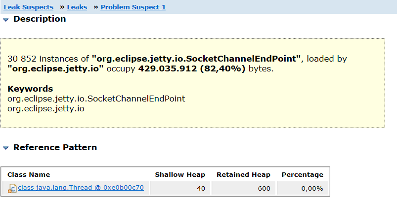

Good Morning,
still the same problem… reverted back to stable OH 2.4.0, all rules are still disabled, only one permanent android client and after some days again a crash. i also removed the hue binding because i thought this
one is the reason but wasn’t … currently i have no clue where the root cause of the problem is…
 ![2018-12-31%2008_02_04-Eclipse%20Memory%20Analyzer](https://community-openhab-org.s3.dualstack.eu-central-1.amazonaws.com/original/3X/d/3/d319cdb6d3d052fff48816f65a31f4ec854c49af.png)
currently i’m thinking about restarting openhab during the night so that i can use the automation again…
Cheers,
Hans
