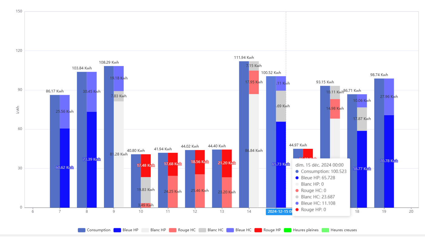

Hello All,
I experience strange behaviour on chart with multiple timeseries, possibly an issue/bug.
My chart have several series, in the exemple 9 different series.
The Consumption series is the grand total.
This total can be composed of 2 different subseries:
  • “Heures pleines/Heures creuses” subseries.
  • Or Bleue HP, Blanc HP, Red HP, Bleue HC, Blanc HC, Red HC subseries.
The subseries will depends on the date, where different tarif applie. Sometime you will only have value for the 1st subseries, or sometime for the 2nd subseries.

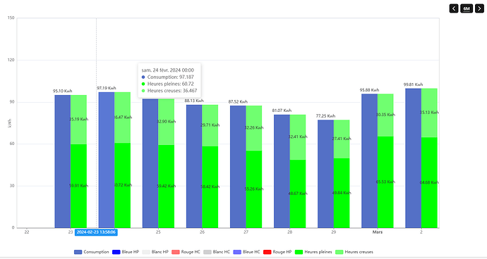

When everything is ok, the grand total should be equals to the subseries sums, like in the graph bellow.
Or this one, with the 2nd tarif.

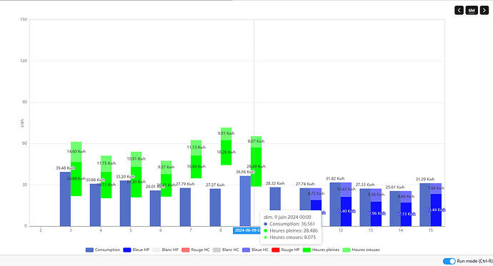

But when I set the graph to cover a period with a tarif change, I’ve get the following result.
The tariff change occurs on 9 june.
Note that data are correct :
total cosumption = heure pleines consumption + heures creuses consumption
36,56 = 28,49 + 8,07
But notes that the start of the bar on y axis is not zero based, like if the other series that at this point have no value take some places on the y axis ?

This is pretty clearly a bug. The only problem is figuring out where the bug is. My gut feeling is that this is an eCharts bug and not OH, but I have very little evidence to support that hypothesis.
I can try to export my data to json, and try to reproduce the graph directly with echart.
That will potentially help to narrow the issue.
But I see other strange thing this last days.
I have some graph that display correctly at first, but when adding the toolbox to the graph, some value in timeseries just disapear and not displayed.
Laurent.
