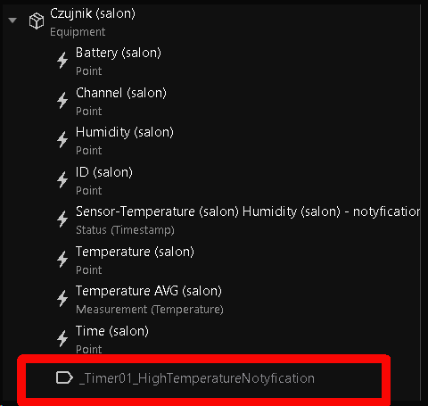

But once I created an item that has a “strange” icon in the model, I can’t see it pinned to anything, and it’s not visible anywhere in the channel list in thig.

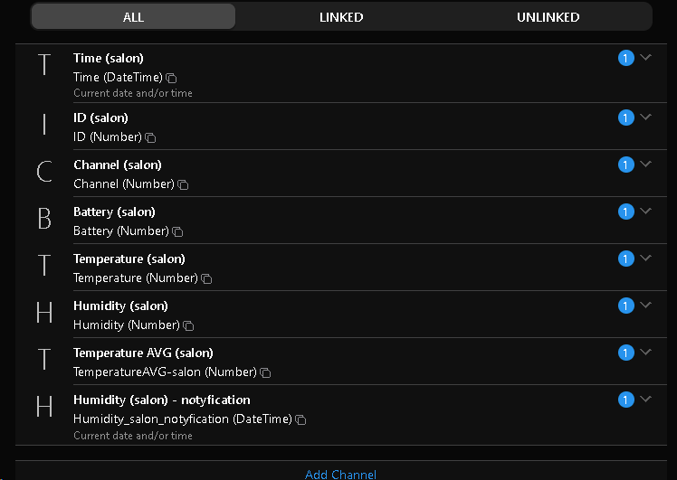

This item is not visible on any of these channels (after expanding each of them).
Is it normal that I can’t find it pinned to this thing anywhere? I noticed this because after upgrading to OH 5.1.0, this item suddenly appeared in the model without a parent. So I set a parent, but it has a ‘strange’ icon.

No, but if there is something mess up with the link between the Channel and the Item it won’t show up there,

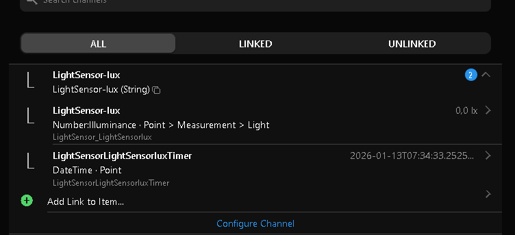

excatly - channel with 2 items looks like following:
and the second item is updated by rule. In this example time.

As for where the Item appears in the semantic model, without the Item’s configuration :person_shrugging: . Based on the screen shot that Item has no semantic tags on it.
The model doesn’t have any direct connection to Things. The model is an organization of Items only. It is true that you can use Thing Channels to quickly create Items that are organized according to the semantic model, but that is just a shortcut. Just because you see an Item listed as a point in an equipment does not mean that Item must be linked to the Thing that equipment represents.
That equipment node in the model is just a Group Item. Your “strange” Item is definitely a member of that Group. Go to the Items page and search for your equipment Item in that page and click on it to see its details and you will see your “strange” item listed as a member of that group.
If you go to the page for the Item itself, my guess is that you will see this:
Indicating that there is no Channel Linked to this Item.
Depending on what you upgraded from, there were a lot of changes to the semantic tags. It sounds like you might have had a tag on this item that was not previously a semantic tag, but has become one in the new tag update so suddenly this item was included in the model. You then moved it from not having a parent to inside this equipment group, but again, that has nothing to do with connecting it to a Thing.
If you don’t want to see this item in the model, then remove it from the equipment group manually and delete whatever tag it has that identifies it as a semantic item.
