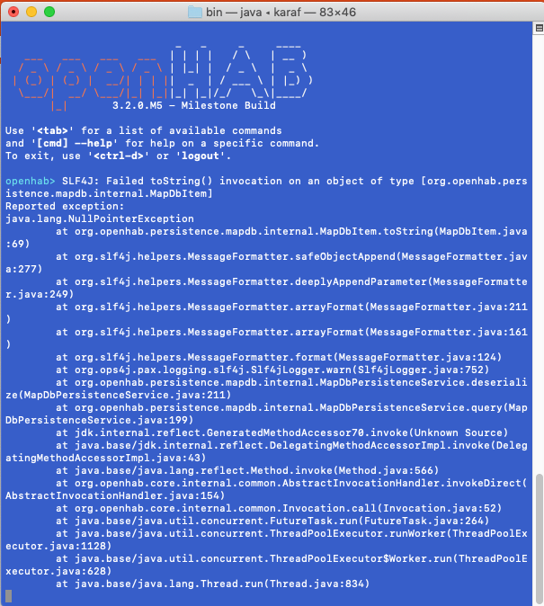

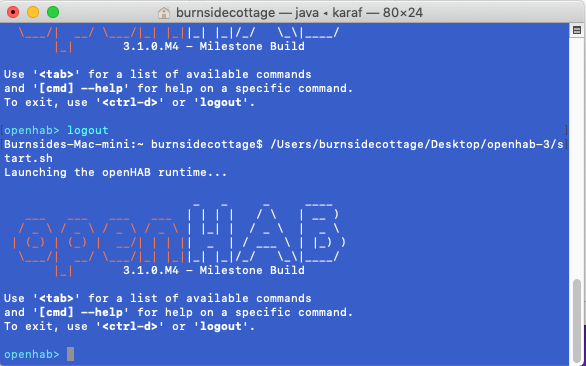

Hi, I was running 3.1.0.M4 and the Terminal startup was always ‘clean as a whistle’.. no cranky messages.. :roll_eyes:
When I upgraded to 3.2.0.M5 I get a load of complaining log messages and I don’t know if they matter or how to stop them appearing if they don’t matter. Can anyone please advise me on this?
I should add that the terminal complain stream also happened when I went from 3.1.0.M4 to 3.1.0 Stable.
I attach the Terminal screen shots and also a sample extract of the openhab log when all this was happening. Thanks in advance

Ok as an update though, I logged out and re-started OH and all those OH log messages about Transformations missing are gone away and the system is working BUT… the complaining stream still came back in the Terminal window.
So the system is complaining about something (which I don’t understand) BUT the OH log is clean now and system is working.
Thus the question remains, what are all those Terminal launch complaints about?? :thinking:
Ok, I seem to have solved it myself.. :nerd_face:
It seems to me that OH3.1 (stable) and onwards is ‘cranky’ about persistence mapdb values.. there are always going to be NULL values for Group items but it won’t ignore them routinely… also I saw org.eclipse.lsp4j in the stream error list (I’ve no idea what lsp4j does :face_with_monocle:).
Anyway, I did a list -s in the Karaf terminal window to get the exact names of the packages which seemed to be upsetting the launch process. I then set the logging levels for those to OFF... using log:set OFF org.openhab.persistence.mapdb and log:set OFF org.eclipse.lsp4j
Then logged out and rebooted OH and now a squeaky clean Terminal Launch window with no complaints and a clean openhab.log
I hope this may help others and maybe the developers might know why earlier OH 3 milestones tolerated these (minor?) errors/inconsistencies

2021-12-12 14:44:31.284 [WARN ] [pdb.internal.MapDbPersistenceService] - Deserialized invalid item: [FAILED toString()]
This is coming from the MapDB Persistence add-on (which has nothing to do with the Map Transformation add-on. Unfortunately this message is a little ambiguous. Is the Item invalid? The state pulled from the DB?
Looking at the code it appears that what is in fact happening is that MapDB is attempting to restoreOnStartup using a corrupted entry. I would guess that at some point OH crashed while writing to the MapDB and one of the entries was corrupted. Unfortunately the [FAILED toString()] doesn’t make a whole lot of sense given the code but I’m not expert on MapDB.
In any case, the solution is going to be the same no matter what. You either need to find the Item whose entry is invalid through trial and error and update or change that Item so that the corrupted database entry is overwritten, or you can just delete the whole MapDB in it’s entirely ($OH_USERDATA/persistence/mapdb) and repopulate it by updating/changing the Items that get saved to it.

Unfortunately the error isn’t very clear what the problem could be. Maybe this is the one Item that has the corrupted entry in MapDB. Maybe it’s something else entirely.
I wonder what happens if there is a Mapdb record and restore instruction for a since-deleted Item.
That was my first thought too but looking at the actual code, the problem is coming from attempting to parse the JSON that is actually stored in MapDB itself. The entry itself is unparsable at all or the entry is missing the Item’s name, state and/or timestamp. I don’t think it’s getting far enough along the process to run into a problem that the Item itself doesn’t exist.
