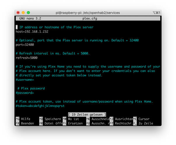

Hello wanted to implement the Plex binding in my openhab system, but it doesn’t work at all. I made it Step by step like the doc :frowning:
my cfg file:
my item file:
Where is my mistake?

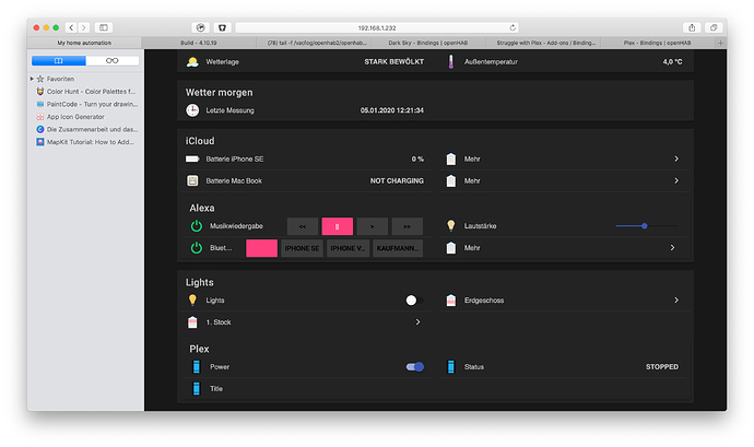

I have now implemented it in the Basic UI.
neither the text item nor the switch does what it should.

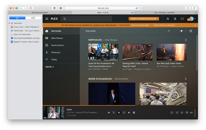

No as I said the Pause Item does not work, too. It says Stopped but the Video is playing…
I also implemented the Title item of the film you are watching. There it does nothing work.
