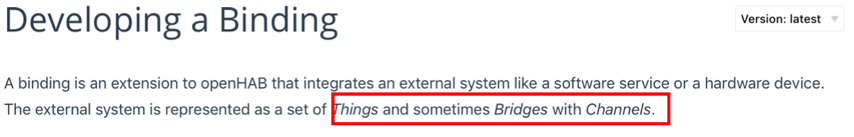

As a general guide. Base on what your understanding seems to be on how stuff works you’ll do good to take a good look at the documentation, otherwise this will end up in lots or repeating of the documentation:
Realise it might seem like I am not aware of the Developer Guide, however, have been using the guide. Still, the guide is a bit vague at some points (at least for me). If that is a result of my incompetence only remains unsaid, however:
Having:
Combined with “Thing and Channel XML reference”, with actual reference to “bridge only” with channels, in addition to similar API bindings using the bridge approach, the correct choice of action was not obvious to me.
