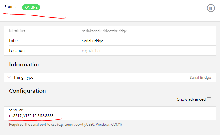

I read on other topics and also on this about serial binding so I created this:
Witch seemed to work, the status changed to online.

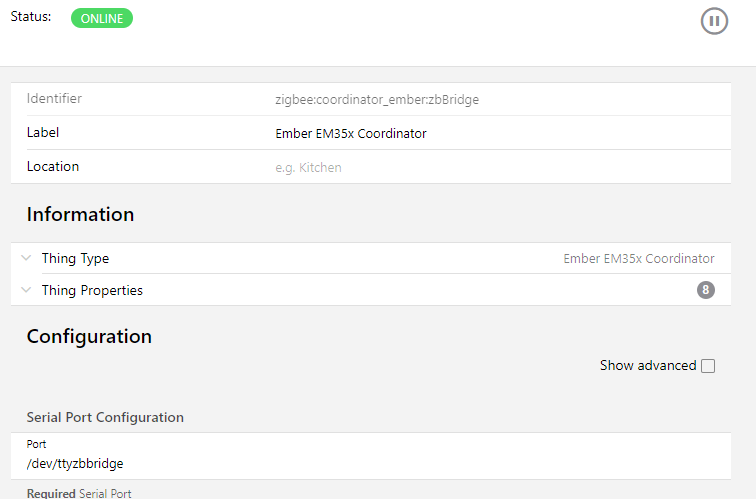

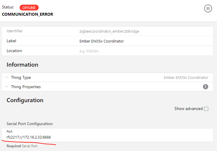

This is my setup
with rfc2217://172.16.2.32:8888 as port and the rest are default.
This is the log
23:09:03.872 [INFO ] [hab.event.ThingStatusInfoChangedEvent] - Thing 'zigbee:coordinator_ember:zbBridge' changed from UNKNOWN to OFFLINE: Failed to open communications port
23:09:03.893 [INFO ] [hab.event.ThingStatusInfoChangedEvent] - Thing 'zigbee:coordinator_ember:zbBridge' changed from OFFLINE: Failed to open communications port to OFFLINE (COMMUNICATION_ERROR)
23:09:08.894 [INFO ] [gbee.handler.ZigBeeCoordinatorHandler] - ZigBee dongle inactivity timer. Reinitializing ZigBee
23:09:08.896 [INFO ] [hab.event.ThingStatusInfoChangedEvent] - Thing 'zigbee:coordinator_ember:zbBridge' changed from OFFLINE (COMMUNICATION_ERROR) to UNKNOWN
23:09:09.897 [ERROR] [.zigbee.dongle.ember.ZigBeeDongleEzsp] - EZSP Dongle: Unable to open serial port

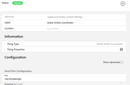

  1. Modified /etc/default/openhab
EXTRA_JAVA_OPTS="-Dgnu.io.rxtx.SerialPorts=/dev/ttyzbbridge"
  1. Executed
socat -dd pty,link=/dev/ttyzbbridge,raw,user-late=openhab,group-late=dialout tcp:172.16.2.32:8888
  1. Created
And it works.

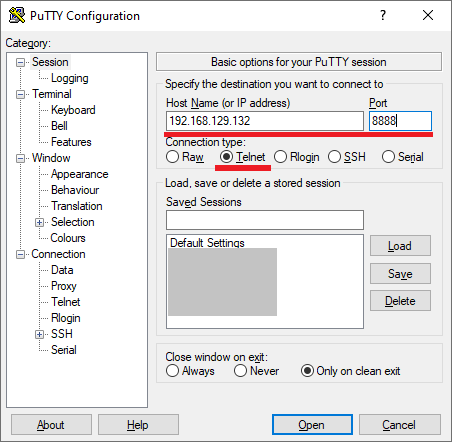

I’m able to open a telnet session with 192.168.129.132:8888

Did you tried to telnet to 192.168.129.132:8888? Maybe the port is closed.
