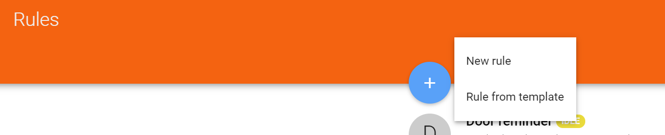

It’s actually already in there. But to create a template you have to basically write the JSON yourself and to import the template you need to use the REST API. Once the template is imported though, you can easily create a Rule from the Template. I think there was some work to publish Rule Templates on the IoT Marketplace but I think the marketplace is going away in OH 3 since it’s an Eclipse service. I’m not sure how they will be managed in OH 3.
