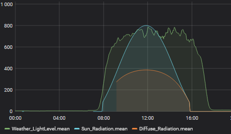

I recently added a simple light sensor outside the house to get an idea of how much light/sun is coming from the sky. It’s a simple LDR giving a 0-1024 value (green curve on the attachment). Mainly tuned for low light levels so the top of the curve is a little bit compressed.
I have also added astro channels like total radiation (light blue on the attachement above)(coming from the astro binding) and I am surprised it is not centered on my light level green curve.
  • Im drawing these two using grafana
  • The time indicated on the X axis is the local time (UTC+1, DST is on)
  • My coordinates are 48.7, 2.3

I also added some other channels to try to explain what was going on:
DateTime         Sunrise_Time       "Sunrise [%1$tH:%1$tM]"                   { channel="astro:sun:home:rise#start" }
DateTime         Sunset_Time        "Sunset [%1$tH:%1$tM]"                    { channel="astro:sun:home:set#start" }
DateTime         NightTime          "NightTime [%1$tH:%1$tM]"                      { channel="astro:sun:home:night#start" }
DateTime         DayLightStart      "Daylight start [%1$tH:%1$tM]"            { channel="astro:sun:home:daylight#start" }
DateTime         DayLightEnd        "Daylight end [%1$tH:%1$tM]"              { channel="astro:sun:home:daylight#end" }
This gives the following values for today (Nov 13rd):
Sunrise_Time changed from NULL to 2019-11-13T07:25:00.000+0100
Sunset_Time changed from NULL to 2019-11-13T16:15:00.000+0100
NightTime changed from NULL to 2019-11-13T18:18:00.000+0100
DayLightStart changed from NULL to 2019-11-13T07:29:00.000+0100
DayLightEnd changed from NULL to 2019-11-13T16:15:00.000+0100
The good thing is that these values are pretty consistent with the blue curve (radiation).
The other good thing is that sunrise time is also consistent with the green curve (actual light)
The bad thing is the sunset time doesn’t match the actual light or the “official” sunset time (https://www.sunrise-and-sunset.com/fr/sun/france/paris) (and what I can see through the window).
Everything is like if the sunset time was incorrect (shifted by 1h earlier)
What did I miss ?
Thank you for your help !

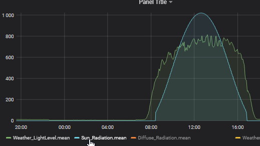

Answering to myself…
I switched from “astro:sun:home:…” to “astro:sun:local:..” and it seems that does the job for the sunset time… A bit too late for radiation as it is nigh time now but my guess is it is now fixed. More to come tomorrow !

much better today :slight_smile:
