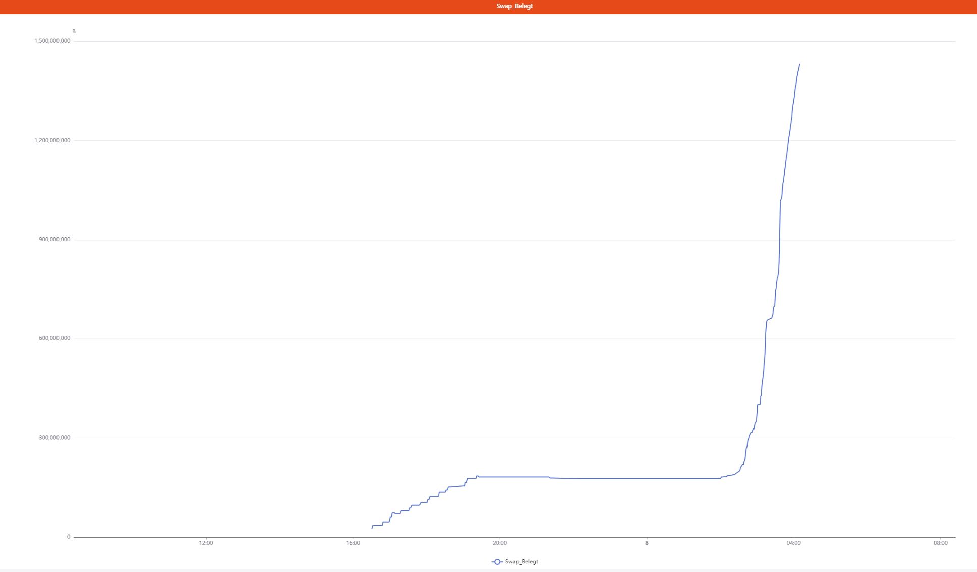

I am looking for some hints on my OH4-Problem described in the Title. Recently Updated to OH4.0.1. I am unable to have Openhab running stable since then. Whenever I restart OH, things are doing well - then after a random amount of time the System becomes unresponsive, the persistence stops working. I had no luck with various approaches based on the forum:

Here is an example from tonight - at around 02:00; when nothing special was happening, SWAP startet Skyrocketing out of the blue and Persistence stopped around 04.00. Nothing unusual to see in the log’s.
