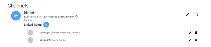

Creating a Switch item on the same channel as the Dimmer item doesnt work. Previously, if you set the dimmer to anything more than 0, it would turn on the Switch item.
The item is Node 25, Aeotec Nano Dimmer ZW111/ At 08:49 you see I send 70% to the dimmer item. The switch channel remains in NULL despite the dimmer item being 70%

The switch item is bound to a group, type switch. It is grouped with many other Zwave items which are Switches, not Dimmers. I use the group to display the number of Switches that are ON. This allows me to monitor how many lights are on, be them being a switch or a dimmer. It doesnt matter.
The dimmer item is used as a slider to drag the value from 0 to 100, to dim the lights. You cannot send a dim value to the Switch item.
Therefore, I need BOTH Item Types for the device.
