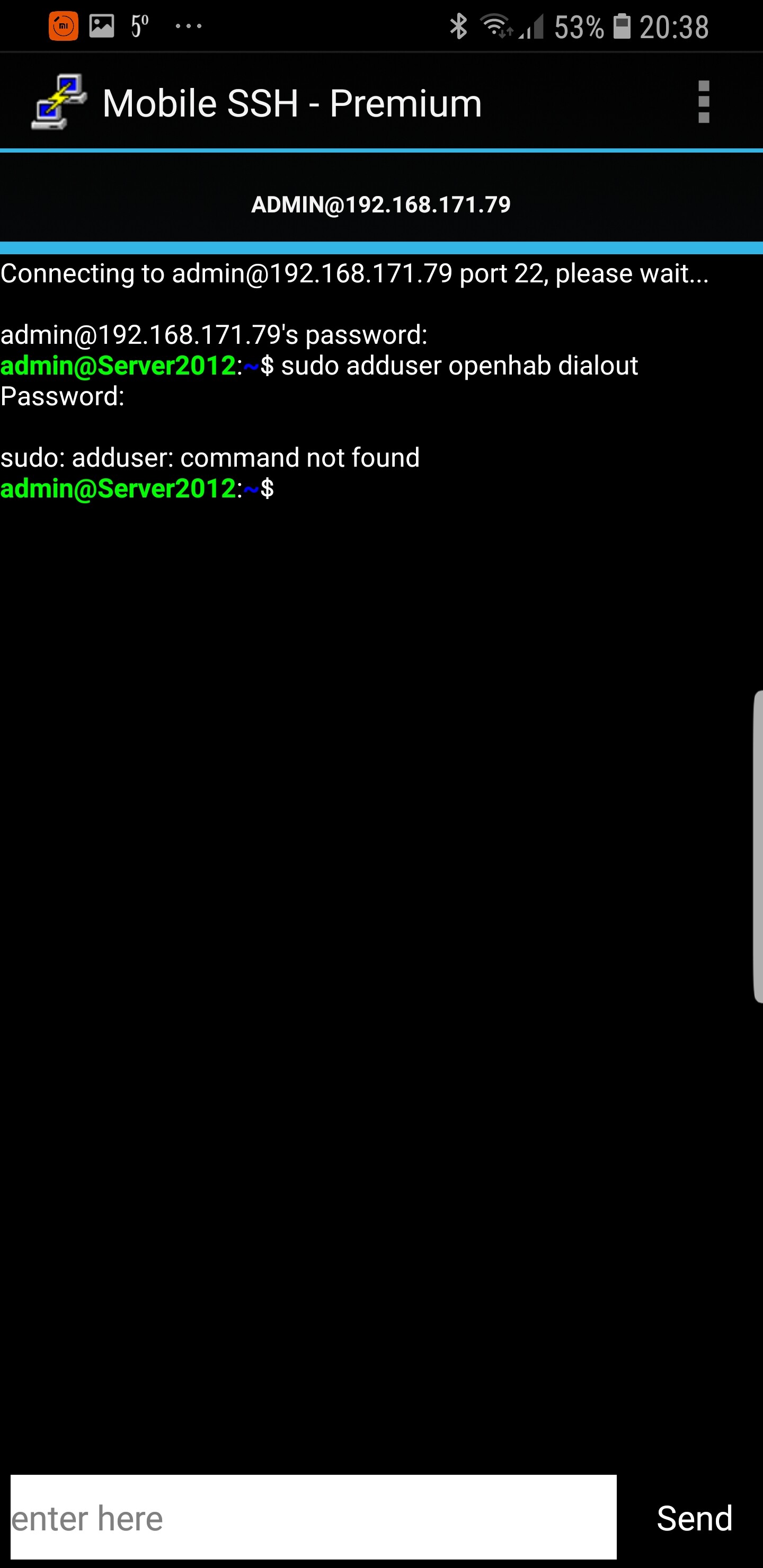

Hello I’m new to openHAB. Have already included a lot. I have installed openHAB on my Synology. I would like to integrate the Zwave USB stick Aeotec 5.Gen. Unfortunately, the system does not find the serial port. The description explains how to bring the user openhab into the group dialout. Unfortunately I get an error message as shown on the picture. Is Linux different on Synology? Can someone help me?

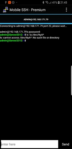

post the output of:
ls -la /dev/ttyA*

OK I have the answer. You don’t need the ssh. You can config the parameters for the users direct in synology webgui.
