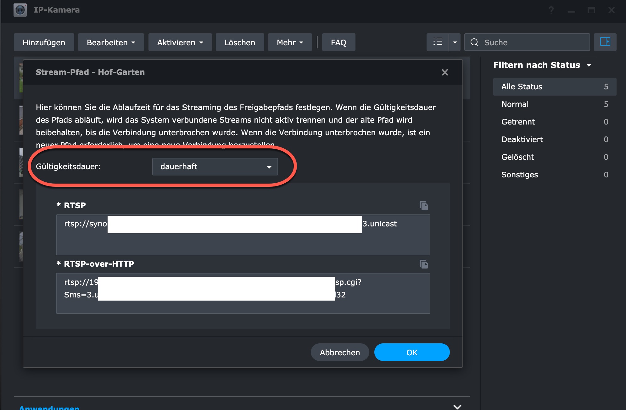

i am trying to get the mjpeg streams into my Hab Panel. When i copy the URL from the string item i linked to the “live feed url” channel, it works for some time. However, it seems that this URL changes after some time which results in a blank image in Hab Panel.
Is this a normal behavior of this binding? How can i fix this?
Hi @Beasty,
right click on Camera → share Stream Path → validity: choose “permanent”.
Screenshot is unfortunately in German:
@April_Wexler
Oh my… this might help, haha :wink:
