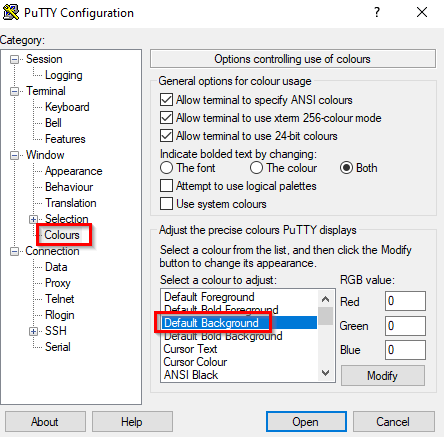

The colors are controlled by putty. I donāt think there is much of anything you can do from the server side.
If you go into the PuTTY Window Colours menu go down to ANSI Blue and increase the Blue number. You can add some to RED and GREEN (the same value) to brighten it as well. You may want to play with ANSI Blue Bold as well. Iām not sure which. Make sure to save the session so it remembers the adjusted color the next time you connect. Note that changing these values do not affect any PuTTY session you currently have open. It only affects new sessions.
I donāt know why the default color scheme in PuTTY uses such a dark blue on a black background. KiTTY doesnāt use such a dark blue which is why I often use it instead. My favorite is to use Bash for Windows or the Ubuntu app from the Store. Then I donāt even need PuTTY. I can start with a Linux like environment from the get go.

I know how to change the Karaf Console printed (highlight) colors per the C:\openhab-3.0.2\userdata\etc\scripts\shell.colors.script file. Does anyone know how to change the background color from black to white. Iām running OH3.0.2 on Windows 10 and occasionally do screen shots, then print them. The black background makes for unreadable hardcopies. I also find black backgrounds hard to read.
Thanks for your help.
I donāt know how/if but why not select the text and copy/paste it into notepad prior to printing? Not only will it be more legible but youāll be able to search and you wonāt be limited to a single screen.
