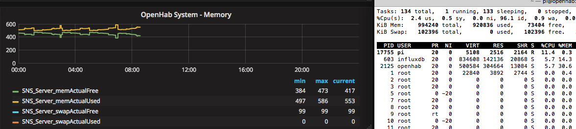

I’m a bit at a loss why my system memory doesn’t appear consistent in openhab through sysinfo… below is a screenshot of my influxdb persisted item states and a TOP output from my OH server running on RPI3.
OH reports 417 MB free, 553 MB used … but TOP reports 73 MB free, 920 MB used.
The numbers don’t line up with the OpenHab service… but it’s closer. I re-read the wiki page… but I don’t think I have my items misconfigured… any help or insight would be appreciated:
