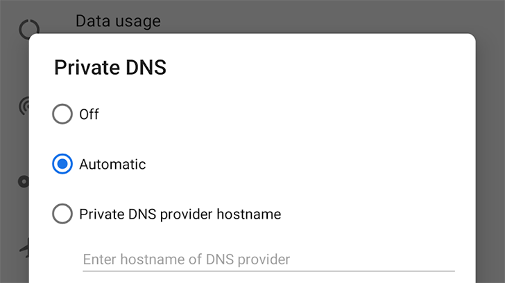

What Phone do use? Which version of the OS?
Android has a new option “private DNS”
I’m on a Pixel 2 XL running Pie. I was under the impression that Private DNS just secured the DNS queries themselves.
Regardless, when I tried to put in my gateway as the DNS I immediately lost internet connectivity had to restart my phone to get everything back to normal. I wonder if pfsense doesn’t support secure DNS.
But even if that did work it wouldn’t be a good long term solution because that sets the DNS for the whole phone no matter what network I’m connected to and what I need is to use my home DNS when on my LAN or connected by OpenVPN and whatever Verizon provides the rest of the time.
