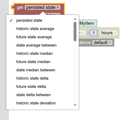

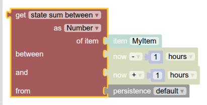

You need to use the "get " block to query for the states stored in persistence.
There are tons of options but you’ll mostly need the “sum between” option.
You’ll need to supply whether you want a plain number or a quantity, which Item to sum the states for and the start and stop timestamps to sum between.
And then just post the result as an update to the Item you want to store the sum.

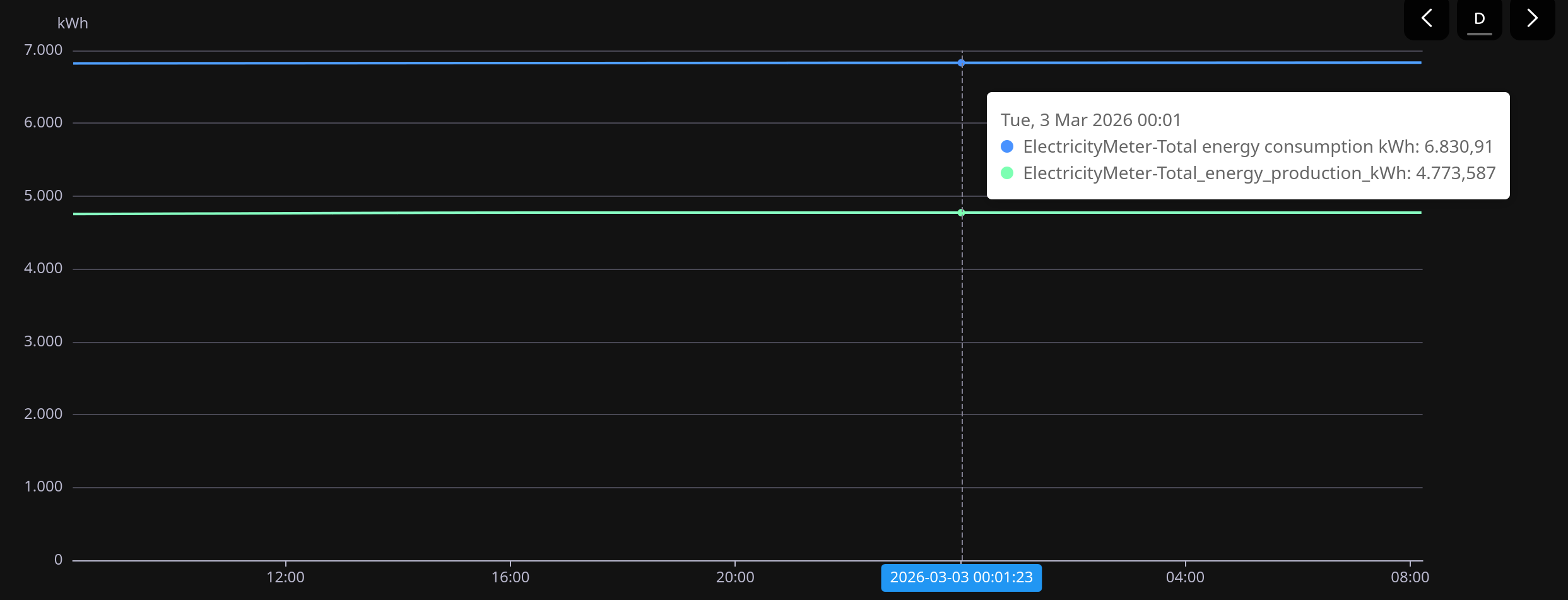

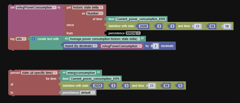

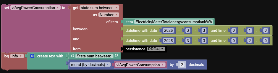

The energy meter displays cumulative consumption, so I can’t add up the total because the reading itself is a total. Even if I take a very short time interval—1 minute—it shows absurd values ​​(like a log), and the meter logs consumption approximately every 3 minutes. So, the interval total doesn’t work, and it doesn’t work even over a very short time interval.

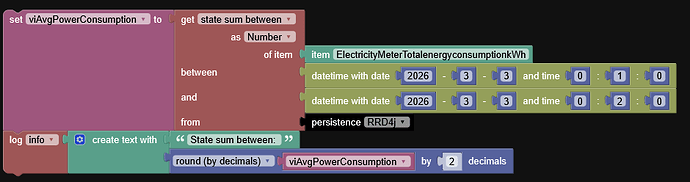

04.03.2026 08:19	 [INFO ]	 [tomation.jsscripting.rule.3e9725c5c9] - 	State sum between: 49182552000.00

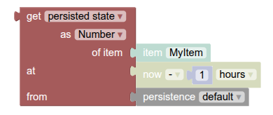

OK, then get a historic value at the time you want it instead of a sum or an average. Like I said, there are many options.
Hohohoho! It works! Thank you.

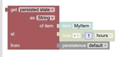

Previously I tried to use ‘persisted state’, but there was “String” instead of “Number” and I got error “.toFixed is not a function in” that’s why I published the post with ask to help me.
And now I changed it to the “Number” and it works perfectly!

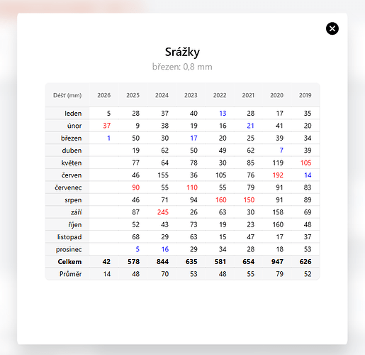

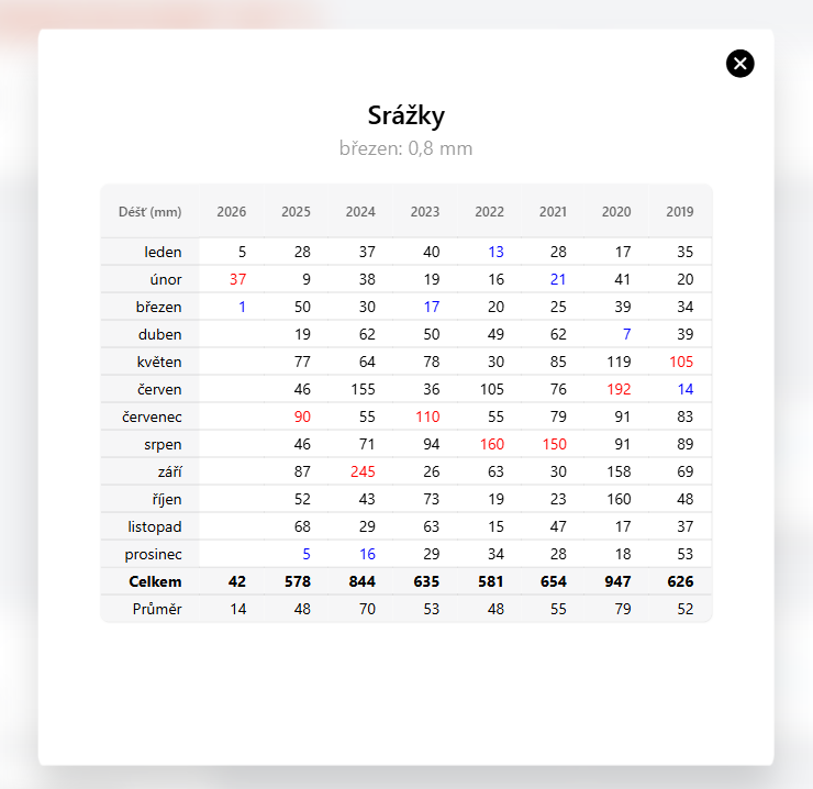

Recently I also wanted to display some historic data in a table. I wanted to display complete history of my precipitation measurement (monthly values + yearly sum).
Here is how I did it (for those that are interested):
  • I created a rule (plain javascript) that calculates same set of history data for items tagged with particular tag (#historic-data)
  • it obtains values back in time until there are no more values, using persistence and persistedState at the end of each month
  • it then serializes all values into JSON and save it to another item (same item name + “History” suffix)
  • then created widget that uses the JSON from history item and renders table for all measured values
I used that widget in expanded cell in my overview page. Currently just for Rain and Electricity consumption, but I plan to extend it.
Here is how it looks like:
Min and max values for a year are marked red and blue. At the end there is a sum for year (Celkem) and average for year (Průměr)

Min and max are part of the JSON data.
Here is the widget code (I translated the month names to english)

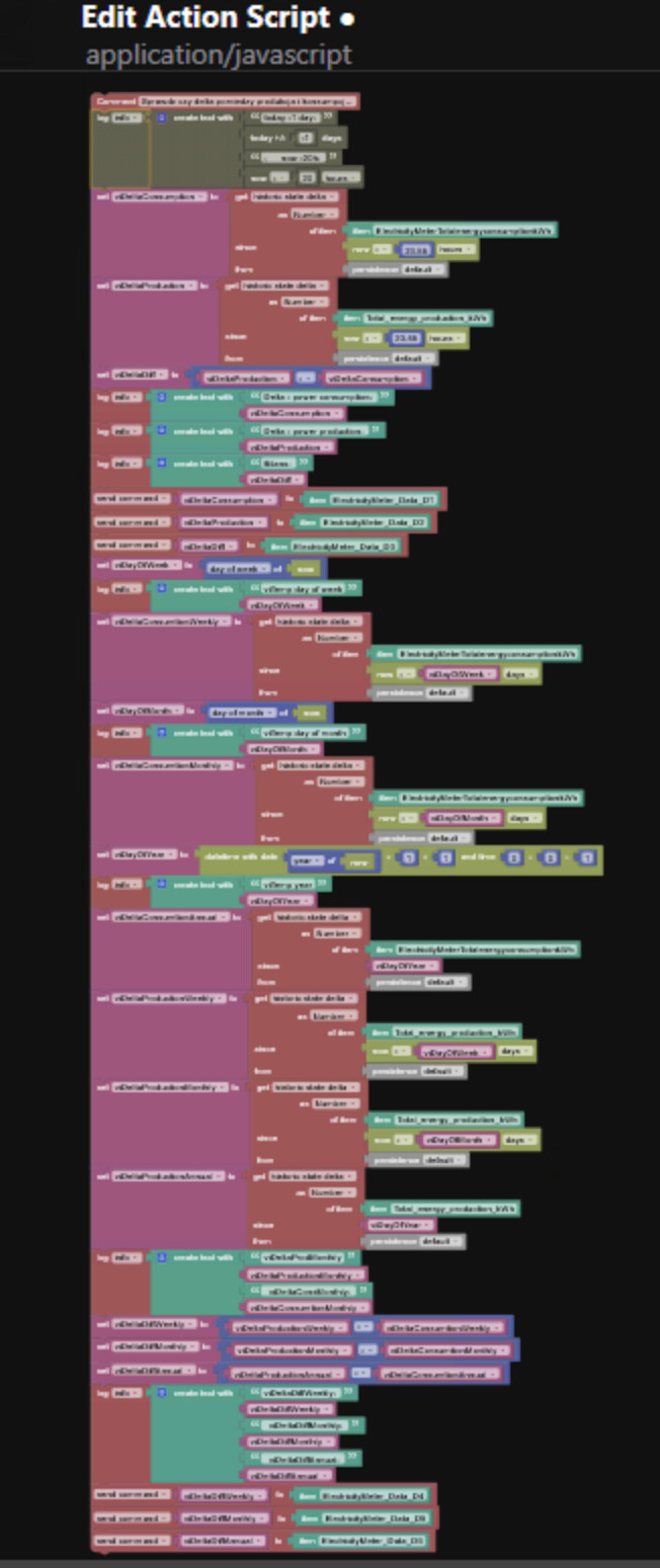

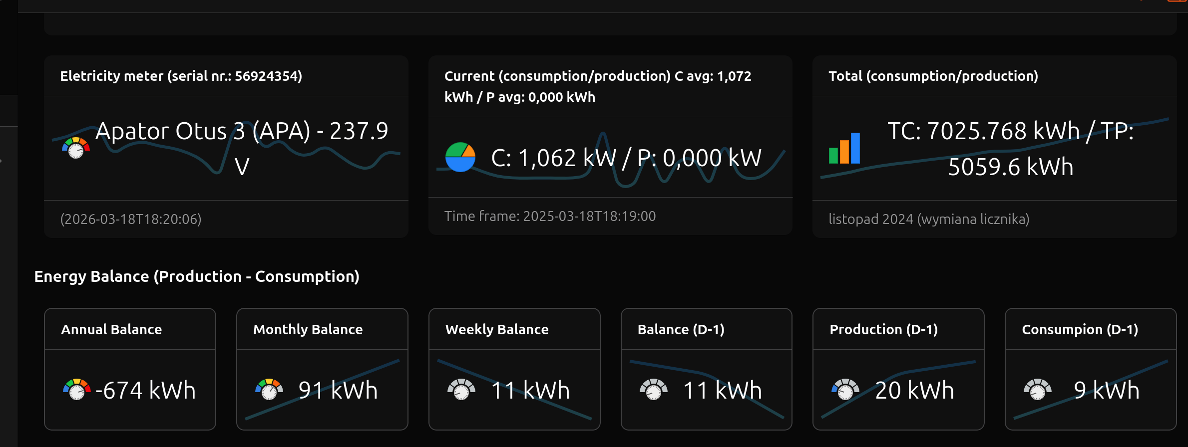

I have to brag!
I made a small inception - “persistence from persistence (results)” :slight_smile:
So, every day, I save the results of persistence of the delta of production and electricity consumption per day, per week, per month, per year in a new items, which means a total of only 6 new items and present some summary like following:
This allows me to:
a) use historical charts in new items, for example, to see whether the monthly production balance is decreasing (I’m consuming more electricity than I’m producing) or increasing (I’m saving electricity).
b) by doing persistence on new items, it allows me to see historical results, for example, for the delta for the previous 6 months.
The OH platform is simply brilliant(!!!)
Everything is in blocky and mechanisms without additional add-ons :slight_smile:
And my blocky at the end :slight_smile:
Unfortunately the blockly image is so decimated it’s completely illegible. To share your code in for easier for others to study and/or use consider clicking on the code tab of the rule and pasting the text you find there. That will include the XML that makes up the blocks as wella s the JS the blocks are translated into .
Use code fences.
code goes here
Right!
Here is the code:

items.getItem('ElectricityMeter_Data_D4').sendCommand(viDeltaDiffWeekly);
items.getItem('ElectricityMeter_Data_D5').sendCommand(viDeltaDiffMonthly);
items.getItem('ElectricityMeter_Data_D6').sendCommand(viDeltaDiffAnnual);
viDeltaConsumtionAnnual = items.getItem('ElectricityMeterTotalenergyconsumptionkWh').persistence.deltaSince(viDayOfYear)?.numericState;
viDeltaProductionWeekly = items.getItem('Total_energy_production_kWh').persistence.deltaSince(time.ZonedDateTime.now().minusDays(viDayOfWeek))?.numericState;
viDeltaProductionMonthly = items.getItem('Total_energy_production_kWh').persistence.deltaSince(time.ZonedDateTime.now().minusDays(viDayOfMonth))?.numericState;
viDeltaProductionAnnual = items.getItem('Total_energy_production_kWh').persistence.deltaSince(viDayOfYear)?.numericState;
viDeltaDiffWeekly = viDeltaProductionWeekly - viDeltaConsumtionWeekly;
viDeltaDiffMonthly = viDeltaProductionMonthly - viDeltaConsumtionMonthly;
viDeltaDiffAnnual = viDeltaProductionAnnual - viDeltaConsumtionAnnual;
