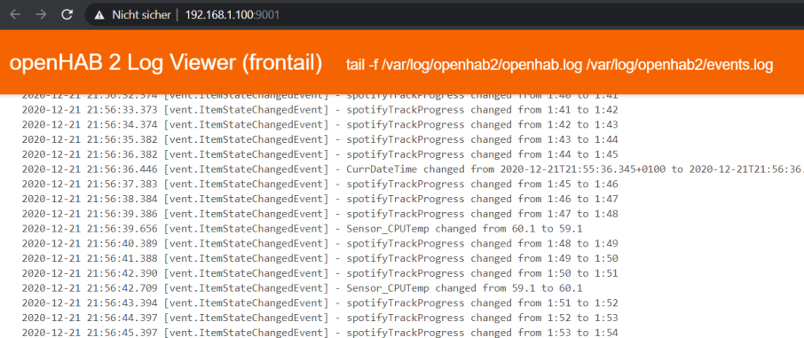

this is the error im getting:
2021-03-15 20:45:05.757 [INFO ] [ab.event.ThingStatusInfoChangedEvent] - Thing ‘tapocontrol:P100:c3583b3043’ changed from UNINITIALIZED to INITIALIZING
2021-03-15 20:45:05.765 [INFO ] [ab.event.ThingStatusInfoChangedEvent] - Thing ‘tapocontrol:P100:c3583b3043’ changed from INITIALIZING to UNKNOWN
2021-03-15 20:46:25.327 [INFO ] [ab.event.ThingStatusInfoChangedEvent] - Thing ‘tapocontrol:P100:c3583b3043’ changed from UNKNOWN to UNKNOWN (COMMUNICATION_ERROR): Login Error
Can you post the link where the login details are sent please
Can you please let me know the web address that you are using to login, I have 2 separate tp link devices and they both use different apps to login and both of those can use different password, I was trying to login using tp link cloud site so if that’s not the one you are using that could be my problem
@besel your getting the error as the jar is for 3.x and your on 2.5.x
It won’t work unfortunately unless you recompile changing the necessary bits or get the dev to compile a 2.5 version
@Bigdesaster you just need to change OH-INF to ESH-INF and all your core imports from org.openhab to org.eclipse.smarthome.
Also Pom version
Then just compile within the 2.5.x addon branch
