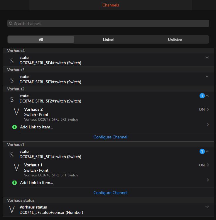

I run several Tasmota devices via MQTT Autodiscovery, everything is running as it should except the Sonoff 4CH Pro.
All Things and Items are UI configured!
I am switching 2 channels of the device with a rule.

As you can see in the log, the Switch ‘Vorhaus_DC074E_5FRL_5F2_Switch’ does the command twice but in the Tasmota console just once.
If i change the Items in the Rule and trigger the Switch ‘Vorhaus_DC074E_5FRL_5F2_Switch’ first, the other Switch does the Command twice.
This happen only with the Sonoff 4CH, two Sonoff Basic with the same Rule are working.

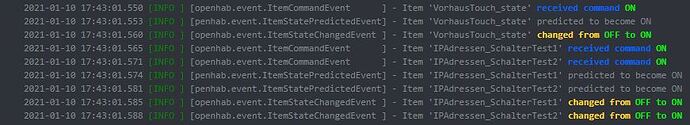

If i set up the MQTT Chanels manualy with the same Rule (different Items) the behavior is as it should be.
@rule("Vorhaus")
@when("Item VorhausTouch_state changed")
def Vorhaus(event):
events.sendCommand("IPAdressen_SchalterTest1", "ON" if event.itemState == ON else "OFF")
events.sendCommand("IPAdressen_SchalterTest2", "ON" if event.itemState == ON else "OFF")
The log shows this
17:43:01 MQT: stat/tasmota_vorhaus/RESULT = {"POWER1":"ON"}
17:43:01 MQT: stat/tasmota_vorhaus/POWER1 = ON
17:43:01 MQT: stat/tasmota_vorhaus/RESULT = {"POWER2":"ON"}
17:43:01 MQT: stat/tasmota_vorhaus/POWER2 = ON
Could this be a Bug?
