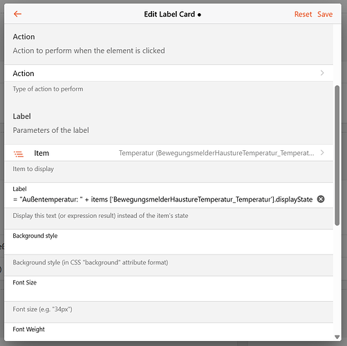

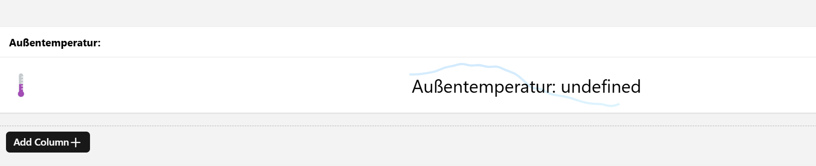

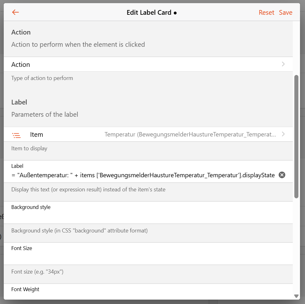

I am talking about a Page > Layout setup – see some screens below.
The widget is a label card and both state and displayState are currently returning “unedfined”.
I also tried with @ (also once without quotations) and this returns a “-” instead of the temperature.
Summarized, currently no idea how to combine text and an item state within a widget label.
The code of the label card:
component: oh-label-card
item: BewegungsmelderHaustureTemperatur_Temperatur
title: “Außentemperatur:”
trendItem: BewegungsmelderHaustureTemperatur_Temperatur
icon: temperature
label: ‘= "Außentemperatur: " + @BewegungsmelderHaustureTemperatur_Temperatur’
